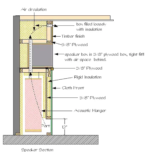

Nice work, but shouldn't your soffits be vented? John Sayers' design seems to have reflex-like ports at the bottom and top that let the monitors 'breathe'
I did NOT use his stock design.
My speakers are front ported, and my soffits are open-backed. If you look for "Kendale" over at John Sayers, I followed his basic design - with a few modifications.
My studio is in my house, and I was not willing to make any permanent modifications, so mine is not the best solution - but it is a MILLION times better than it was. :D
edit - and the front of my soffits are incorrect - when I put the new console in, I plan to fix them......

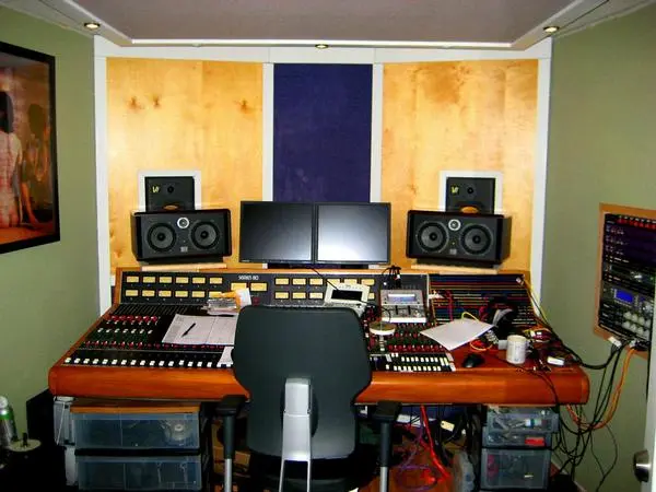

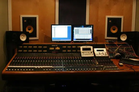

Wanted to update the thread a little. Here is a pic from a little while back -
Here is a newer one - it's a mess in there right now -

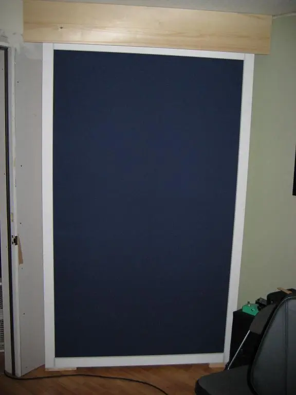

Here is one of the back wall sections. It needs to be trimmed out, as well as the door frame. Will install a center section over the door. Add some lights, and stain and I will be done!

So.. whats the deal with your monitors? I can appreciate having more than one set to check mixes but you are covering your soffit mounted KRKs and it doesn't look like you could easily use them. Are you finding yourself liking the new set better?
