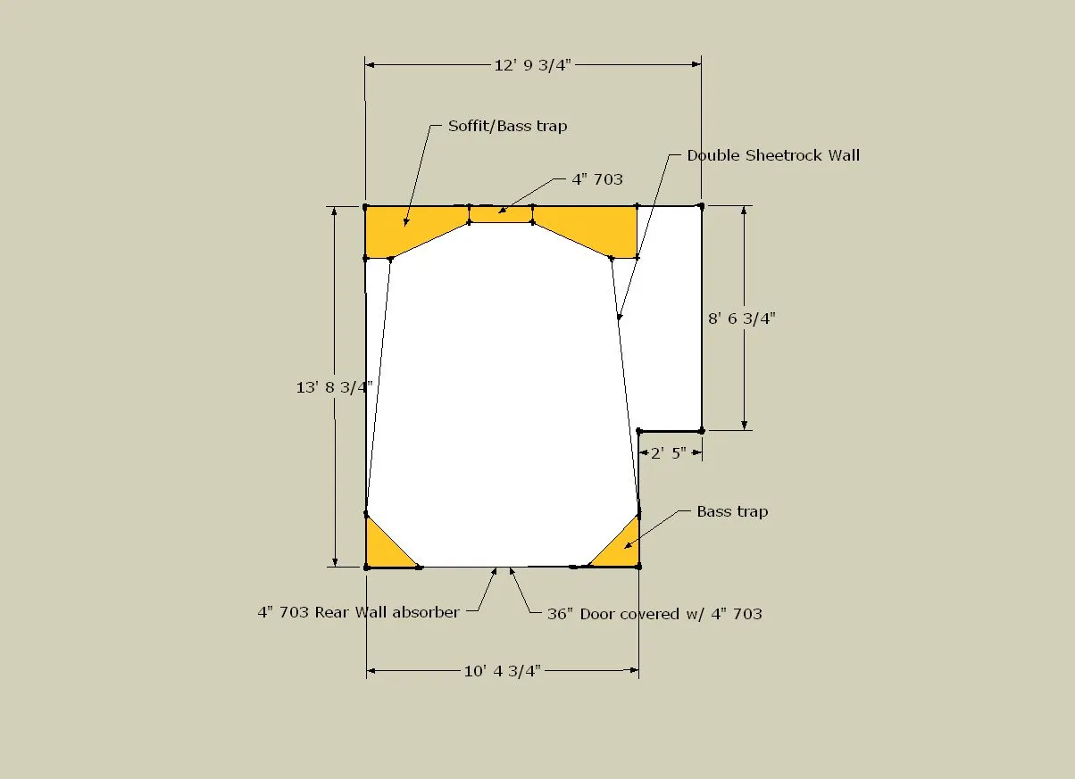

Well, today is the big day. Not a terribly large project, but a handfull for me.
Here is the floorplan -

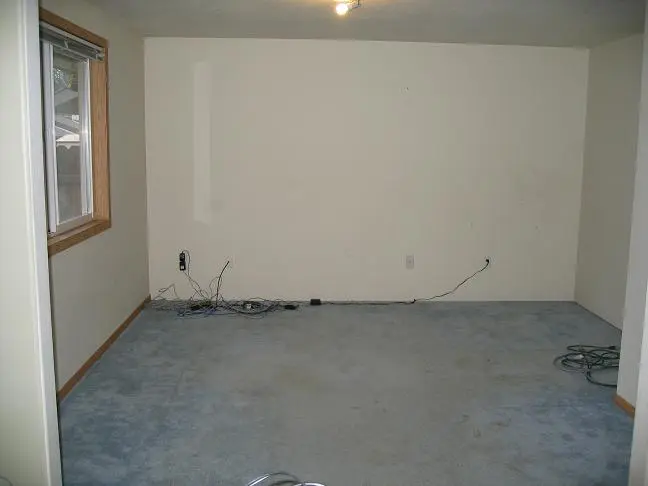

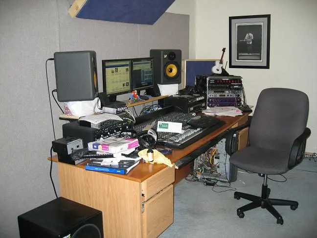

Here is the old CR. The desk is on the left wall in the diagram above. It's kinda messy, I was getting everything out of the room besides the actual desk....

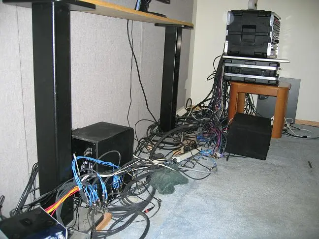

Wires, wires, and more wires - I just hope I can get everything back together!

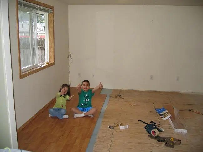

My two assisitants helping with the Mount Vernon Cherry flooring -

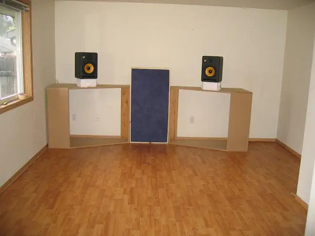

The completed floor with the lower half of the bass trap/soffits (frame only so far) -

what kind of contraption do you have those monitors hanging out on?
They are sitting on the bottom half of the bass trap/soffits. The bottom half will be a bass trap. Stay tuned, I will have more pics soon, and it will make more sense.....

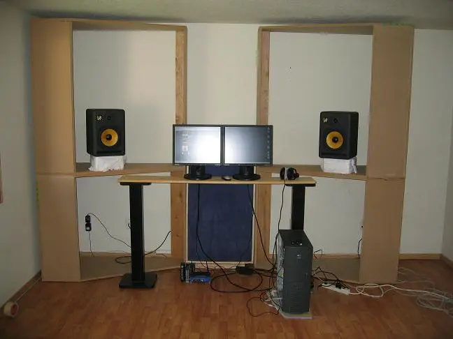

Top half of the traps/soffit are in. I'm going to put 2" 703 in between the two halves which will put them 1/2 from the ceiling.

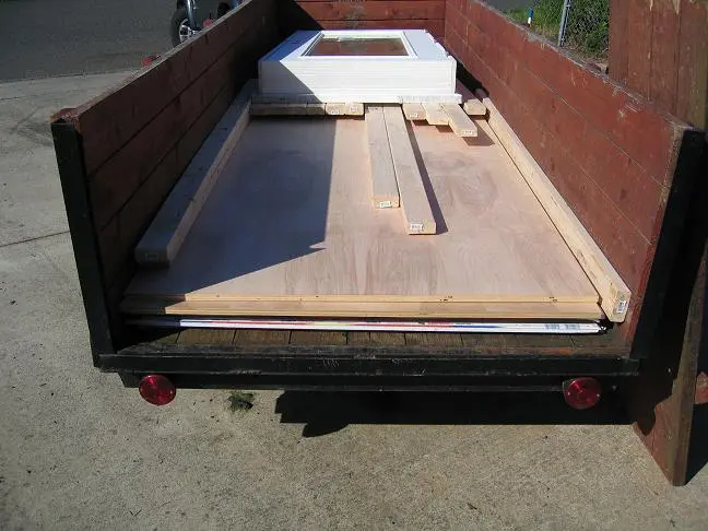

My trip to Lowe's.
Got a $500 custom 36" door for $100. Whoo Hoo! :D Two sheets of Birch Plywood for the front of the soffits, lights for my "cloud", a bunch of 2x4's, and some 5/8" rock.
