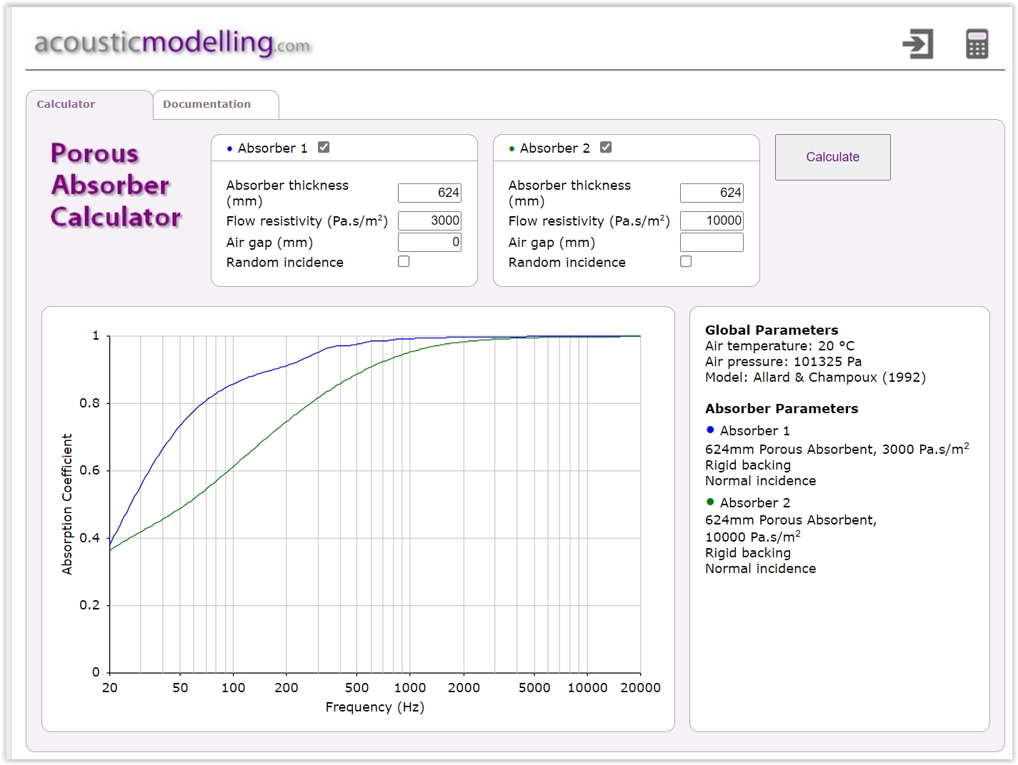

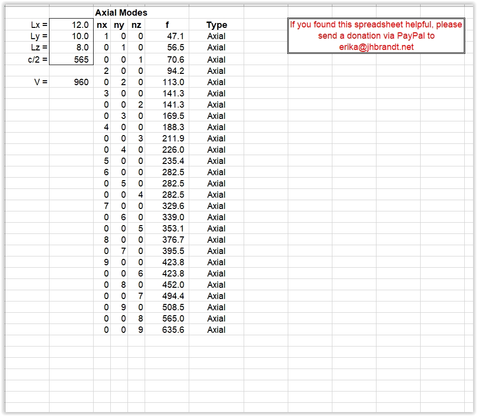

My room is 12' x 10' x 8', and while I don't have a way to measure nor I know the exact units and numbers and terms to use here.... I am trying to control low ends below 300hz, and was hoping that I can reach somewhat decent numbers at 50hz. Reason I am saying this is that I know small rooms like mine usually tend to have bass problems, and I was hoping that I could treat new room so I could hear lower ends better than my older room. My original plan was to put "stacked wrapped fluffy insulation" like I stated in my first post. Now I am leaning toward soffit bass trap design, and I did ask you about the tube trap because I was hoping you could compare tube trap and soffit. Hopefully this makes what I am saying little more clear, and again sorry about weird English.how much of your room do you want the bass trap to take up?
Yes I am aware. I was looking for fluffy because of some people like Ethan or Andre suggested it in other forums. I heard Safe and Sound also works well, which is denser, and so I am still trying to decide should I go for S'n'S or something fluffier, or something denser.By the way Soffit design does not mean soft and fluffy.

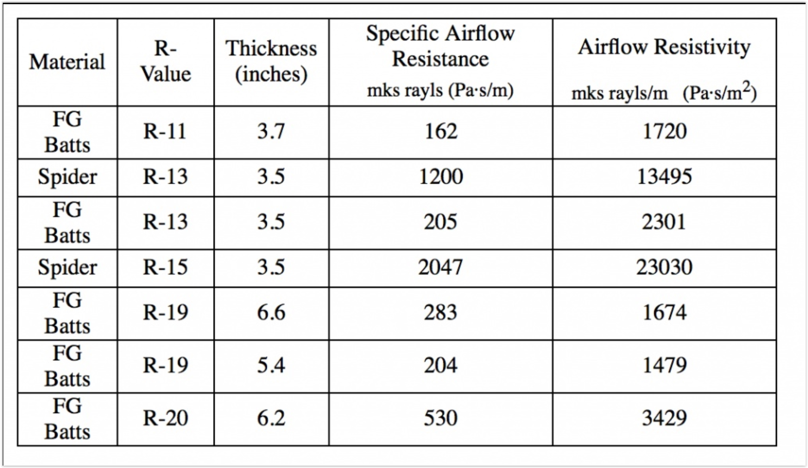

R value is a rating related to insulative value and doesn't directly correlate to density or GFR. R11 EcoTouch has the lowest GFR value. Here is my list of GFR for EcoTouch aka "pink fluffy"Thanks for the reply. After reading all the comments and little more on the web, I think I will try to build a DIY soffit bass trap instead of stacking wrapped insulation. Figured making a soffit would be a lot cheaper and more useful.
Do you by any chance know if their R value is anyhow related to the GFR? Or the R30 is the most fluffy one?

Thanks for an informative answer. I know my questions were not as specific as it should/could been... and I also know there is no perfect answer, and even when following rules and laws it could differ a lot in reality in this field.Don't need to take my word for it. There are plenty of ways to verify what I am saying using the tools that are readily available online.
I'm not so sure why it has to be try and fail. My dad used to say, "measure twice, cut once". This thinking applies. Spend more time planning than constructing is about the best advice you can get. No point in trying to prove that 4+4=10.Thanks for an informative answer. I know my questions were not as specific as it should/could been... and I also know there is no perfect answer, and even when following rules and laws it could differ a lot in reality in this field.
Even so I think it is worth trying lower GFR material for my plan. I know it takes a lot of try and fail, and I guess this is only way to know for sure. Thank you for the information.

Also, if you by any chance know if which Johns Manville is equivalent to 3000 mks rayls/m? It seems my local store usually do not carry OC for whatever reasons, but a lot of JM.
