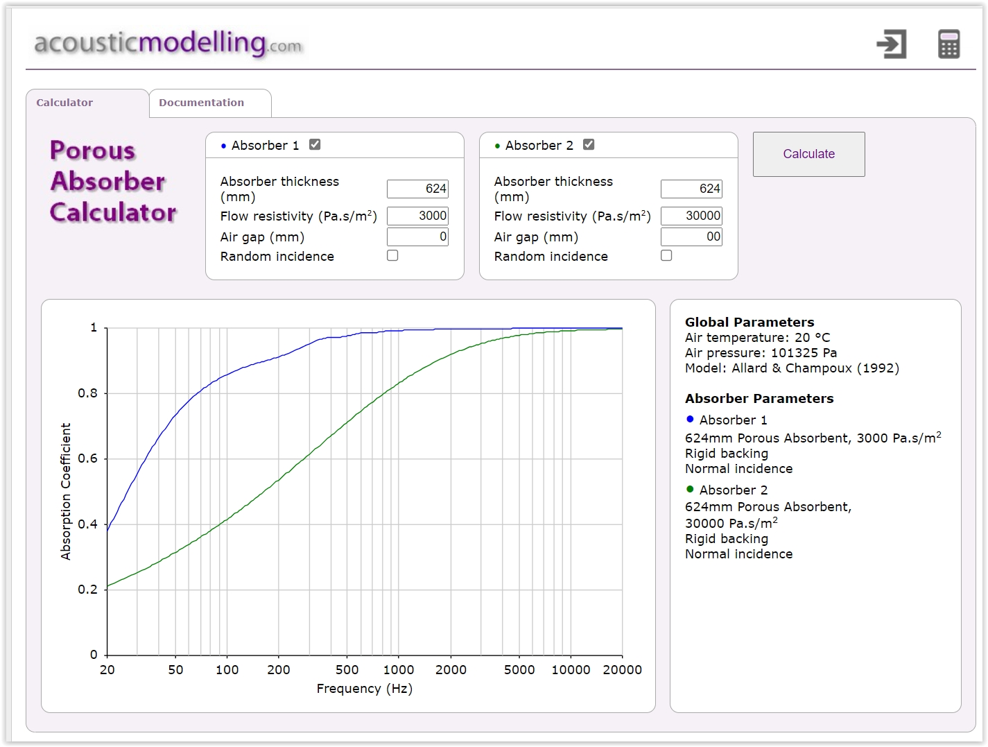

Um, no. In context of bass, the opposite is true. Denser materials become reflective at low bass frequencies at much shallower depths than lower density materials. I posted one comparison. I could compare any material you pick in these calculators and the same would be true.
Here is Owens Corning EcoTouch R38 vs Owns Corning 705 6lb density rigid fiberglass. Same material, different density. Blue is low density. Tell me which one goes lower?

But it depends on the trap design, he was originally talking tube traps and a simple rolled up insulation. If you use high density insulation of say 4" and leave an air gap behind that works in a different way to filling the whole corner completely. I think we are on the same page but its more the explanation than the information.
The devil is in the details and 4 inch of anything regardless of gap isn't going to get you low bass reduction. Based on his room dimensions, he has two fundamental modes that will take more than 4 inches of high density insulation. To say that 4 inches of high density outperforms 4 inches of low density is misleading as neither gets you much in the way of bass treatment. It is the case of being a distinction without any practical difference as a bass trap. At 6 inches low density begins to be about even but still not that effective below 100Hz. Here you are more at broadband absorber than any sort of bass trap. If our fundamental disagreement is nomenclature around what is a bass trap and what isn't, I can accept that. If that is what you mean by on the same page. As to the OP, he seems far more informed later in this thread than initially. I wouldn't completely write him off.
