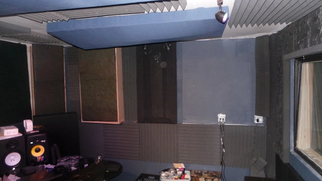

hi all .. thanks for the time of even reading this..
i really appreciate everybodys time.. and how helpful just reading and learning here has been.
i admit i thought i understood acoustics until .. well .. everyday i find out i dont know enough yet lmao..
i have gone the diy route.. with all the help ive read here.. but havent had any major luck on the low end
so heres my deal.. and i cant change what i have so i have to make it work as best possible

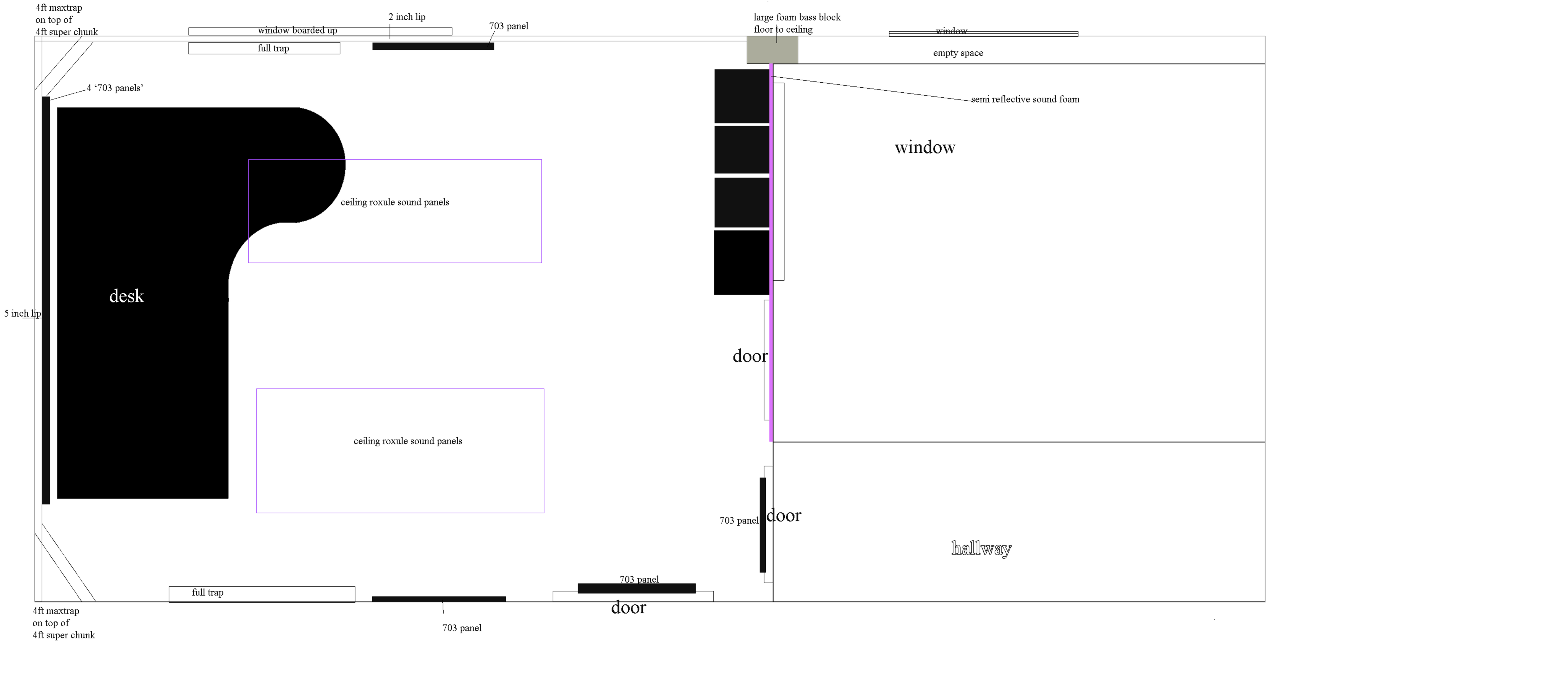

the room is 12 x 12 about 8 ft ceiling with a 5in lip on one wall and a 2in lip on the other with the windows..
ive made a google sketchup file a jpg file took pics.. and everything lol
apollo quad
krk rokit 8's
the 8 in yamahas with the matching sub
so heres what i have.. a s*&^ load of foam and have more coming
2 max traps and 2 full traps
2 superchunks (703) (actually 1 the others materials will be here monday lol)
4 2ft bass traps
8 703 panels fabric wrapped
3 5ft roxule stuffed panels
im open to do what i need to do to get the listening position in order. there is absolutely nooooo bass what so ever
but if i stand up.. i feel like that old maxell tape commercials lmao
ive done the subwoofer crawl doesnt work in here right now.. i even sat with the damn thing in my lap even sat on top of it lol
helllllllllllllp im totally drowned here lol

so lets say i had to maybe loose a foot or add a foot to the room what kind of results would i get?
im not worried about the room being dead as far as the high end goes so im not really worried about the foam
but i wonder if i used enough "bass traps" what kind of results would i get and pertaining to my setup
where would i put them?

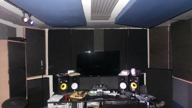

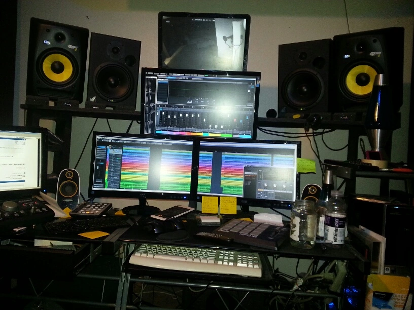

Your monitors are sitting on the desktop, there's a reflection point on the desk because of this. Get them up in the air so that they are pointing towards your ears when you're sitting there.
Good point. If your issue is only in the place you sit, then move the speakers. I have mine above me on a separate platform pointing downward.
yeah im waiting on some monitor stands in the mail they wont be moved up much though because i dont think
moving my main speakers will improve the low end.. i had them sitting 8 inches off the desk before with the same issue

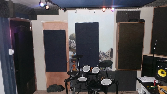

If I were you, I'd take all that treatment out and start again. Start with the corners and works from there. That looks like you've just tried to cover every inch of the wall with something rather than actually treat it. Overkill!

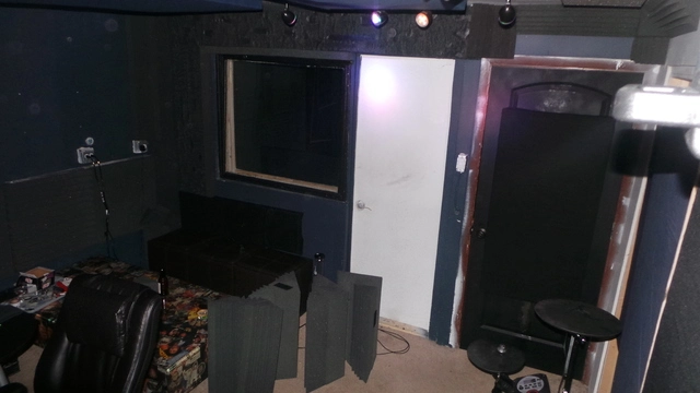

so i ripped down most of the room again..

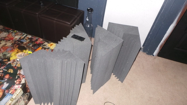

i have the corners treated .. i have a question .. i know now that foam bass traps arent suitable

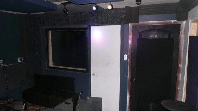

so what should i do about the corner where the two doors meet..
i want to have something that can be moved out the way when i need to leave the room ..
any ideas?

Looking at your photos I get the feeling your monitors are too near your ear..... Take at least one pair, move (and raise) them to the side or your screen.....facing you. Now they should be about 2 and a half, to 3m from you. That is, an equal tri-angle from your sitting (monitoring) position......3m x 3m x 3m.
You can also try moving the whole setup towards the wall behind your chair..... with the result that your speakers are closer to the centre of the room..... That many bass-traps are also suspect to me.....
