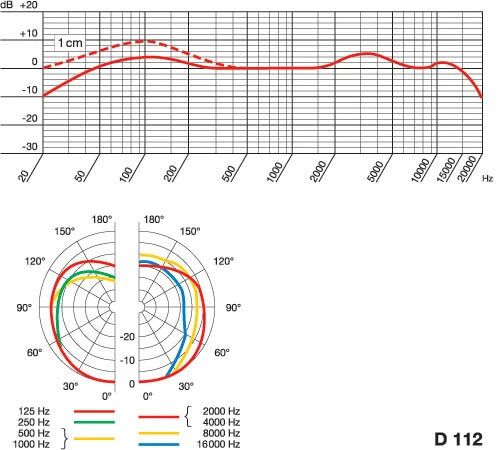

Why don't they just build that drastic EQ curve right into the mic...? :)
That was my point, they do;)
Eq'ing the fundamentals is all we are talking about. The the idea of eliminating overlap has never entered anyones mind. It's impossible. dropping a non-fundamental frequency on one instrument by a couple db's so that another instrument who's fundamentals lay there can peak out and become an active participant in the song is a common thing. Panning is great for creating separation but, when the song is listened to out of a boom box with the speakers less than a foot apart it's effectiveness is limited. Recordings should always survive being played in mono well as well as on head phones etc.
We agree pretty much on most things. Just never forget the end user. You are mixing it for them and they are more than likely listening an a limited bandwidth, majorly eqed system that will not reproduce a truly realistic live sound. Mixes have to be a compromise to make them as universally acceptable as possible or please the most amount of people possible. That means things in the mix will have to under go some possibly unrealistic changes to fit into this midrange world that people live in or at least enough to make them stand out in the midrange.
Anyways. Good talking to ya.
Got to run.
F.S.

I agree... you should be able to flip your monitors to mono playback and not lose anything.

I don't really see that as a "drastic" EQ curve....it covers almost the full auditory bandwidth....there are no severe cuts that make room for other instruments. :)

10db movements on huge sections of bandwidth not drastic or say agressive? I'd say that's very agressive ;)
You just have to keep crapy systems in mind. Not mix to them specifically, just like you have to keep big booming systems in mind. It all lies in having the mids right.

I don't see that the EQ curve of your D112 cuts away anything or makes room for anything....and that's what I understood the "drastic" term was initially about as we were talking about cutting frequencies.
Heck...I think if you are cutting away anything on your Kick tracks, it's probably because the D112 boosts too much LF, so I could see why you might cut to make room. ;)
