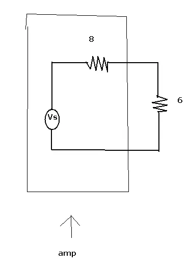

while that's true farview...i am trying to let him picture it like this (see attached gif....ha)
would you say that's not a decent way to view it simply (a thevinens EQ circuit for the amp, and the load)?

It just gives the impression that it works differently than it does. The idea is that you are supposed to match the impedance the output is rated at with the speaker load. You gave the wrong reason why you have to do that. And that whole thing about the power being distributed 50/50 between the amp and the speaker is really confusing. The amp is providing the power to the speaker. If the power is being disbursed between the amp and the speaker, it would need to be coming from somewhere else. That doesn' make any sense.

The diagram is ok. Your understanding of it, amps, and Thevenin diagrams need a bit of work, though. :p
