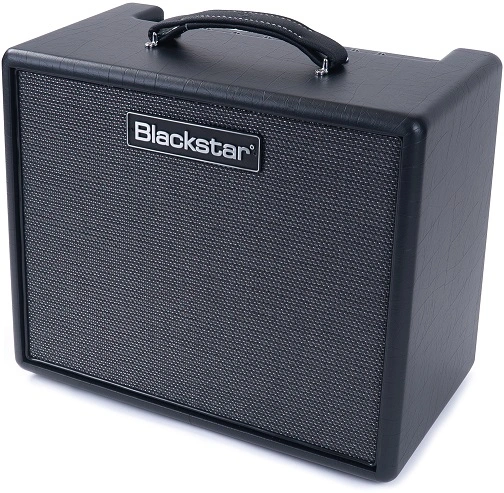

Like the thread name says. I have connected everything like:
Blackstar HT-5R mk3---> Speaker cable (16 ohm)--->Two notes torpedo captor 16 ohm XLR--->preamp--->Audio interface.
I have tried a balanced TRS cable through DI-->preamp instead of XLR, still no signal. I tried a microphone through XLR-->preamp, no problem.
I have also tried to turn on the phantom power on the preamp and plug in a power cable to the torpedo. No DAW/computer settings are changed and there are no problems if i plug the guitar straight into the preamp with a TRS.
I have no idea of what's going on, what am i missing here...?
Thank you in advance.

This may be a bit silly - but you do know the torpedo unit does NOT have an internal speaker and is just a speaker DI box, and it is also rated for a 100W amp input, when you have just 5W coming from the amp? That's a tiny, puny and weedy signal. 5W instead of 100W means the output level from the device to your preamp will be very low. Boosting that in the preamp might generate lots of noise and a bit of a feeble tone? I suspect nothing is wrong, bar you underdriving it. They're usually warning people not to overdrive them. You are just tickling it!

The snag with these is that all they are is a big resistive load, and if you shove 100W in, the little fan cools it down - your amp output gets converted to 99.9% (guess) heat, an .1% audio output. Your 5W won't keep it even warm.
They're not mean to produce a sound, because to do that they would need a big speaker to get any tone, and to get good tone, they'd need to be driven properly.
I'm guessing you bought it to capture some kind of amp effect? Otherwise you could have just slapped a mic on the cab if it sounds really good - but does your amp actually sound good - good as in the tone you want to record? The usual reason for buying these is when you have a great amp sound, and just want to capture that, instead of, or in addition to the speakers. I don't know your 5W combo? Is it one of those 'special' ones?
Due to the square law for power the voltage difference isn't a massive as you might think. 5W into 16R is about 9V rms and 100W is 40V rms...yes, a lot more but you should have got something! I suspect an "operational error" somewhere.
The lil' 5 is a double Triode in fixed bias push pull and if you drive the nuts off it (which is rather the point with a power soak?) it will kick out around 10W (12.6V rms) People have and do gig them into bigger cabs.
N.B. while you are fooling with the amp? I 'think' Blackstar have fitted the speaker 'interlock' to it now that is used on the rest of the HT series?
This means the amp will not output a speaker signal unless there is a plug in BOTH input and a speaker jack. If you are unaware this can lead to hair loss.
