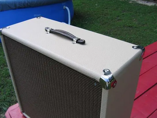

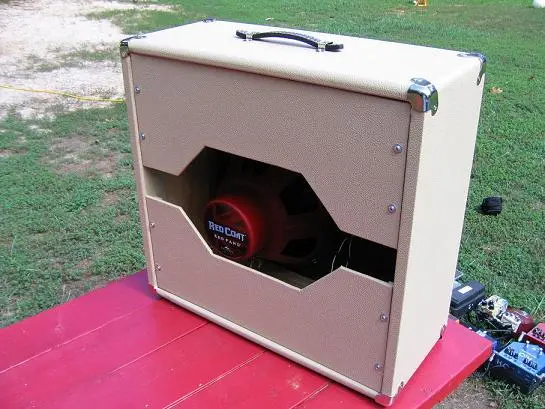

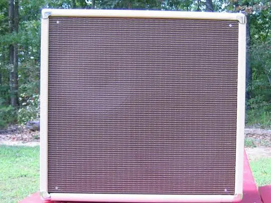

I too have a stock VJr and I run it through this cab that i built.
It's solid pine and it's got a 10 and a 12 in it (old tweed bandmaster style). I bought the baffle from Mojo Musical Supply (already cut and grilleclothed) for $25 and built the cab around it.
The speakers in it are an Eminence Copperhead (10) and Red Fang (12). Let's just say that the VJr sounds pretty great through it! Well, at least as great as a VJr's going to sound. ;)

Thats a great job on that cabinet, the blond tolex and the vintage hardware make it look like new old stock from the early 60's!

I am curious about the mixed 10-12 cab. I've never heard/seen this and always thought that identical (matched) speakers sound best. What would be the practical effect? 10" = clarity/definition and 12" - "beef" and body? How do you go about selecting the specific speakers? Thanks.
You pretty much nailed it--the 10in Copperhead is a very "american" sounding speaker--think "classic blackface Fender" tone. Tons of midrange clarity and punch. The Red Fang is essentially their take on the Celestion Blue--it's got a LOT of low end response and jangly/sparkly high end, but there's not a whole lot of mids.
So in this case, the two speakers complement each other quite well and provide what the other doesn't.
I selected the speakers b/c i had a Copperhead in my '65 Princeton and a Red Fang in a 1x12 cabinet i built. I started using the 1x12 cabinet as an extension cabinet for the Princeton when I needed more volume and was stunned at how good the two speakers sounded together.
So when I saw the baffle for sale at Mojo for far less than I could build one, I jumped on it b/c I figured the two speakers in a cabinet together would be quite nice. I was right. :D :p
I've always preferred complimentary speakers in my multi-speaker cabinets, just b/c i haven't found a single speaker that has all of the qualities I'm looking for. I've found that if you want low-end oomph, you typically sacrifice midrange clarity, etc.

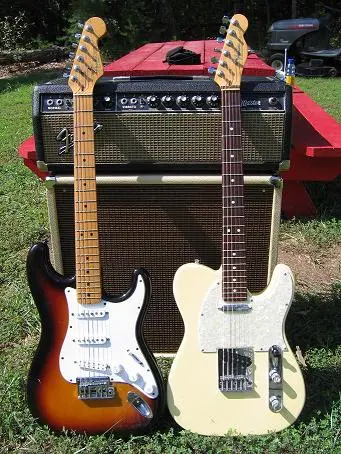

Thanks muchly! That early 60's look was the goal. Since the oxblood w/gold grill cloth was already installed on the baffle, I figured I could go either blond or tweed, and i don't really dig tweed too much (and it's a LOT more expensive than tolex!). I'm in the process of building a matching head cabinet for my modified '74 VibroChamp. I think a 6W mini-piggyback "Vibromaster" would be COOL.
Here's a couple more pics--one of the hardware detail and one "family photo". :p
cheers,
wade
