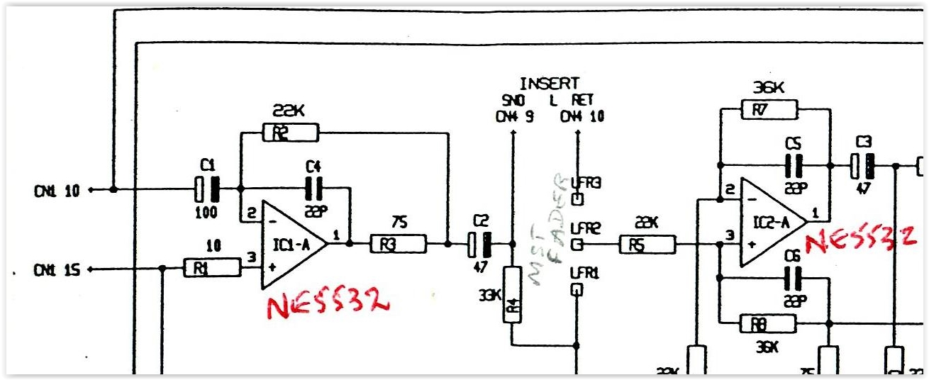

I cleaned all my sockets with a stiff bristle brush used for rifles (22cal from memory) and Caig De-Oxit. This can be done without pulling the console apart. That said, I have had mine totally stripped down some years ago to clean all switches and pots plus do the 10dB/4dB modification.........I stood the console up and made sure it was supported from tipping over and undid all the screws holding the bottom cover plate on, pretty straight forward.
Here's a screen grab of the Spirit Studio master insert schematic.........
