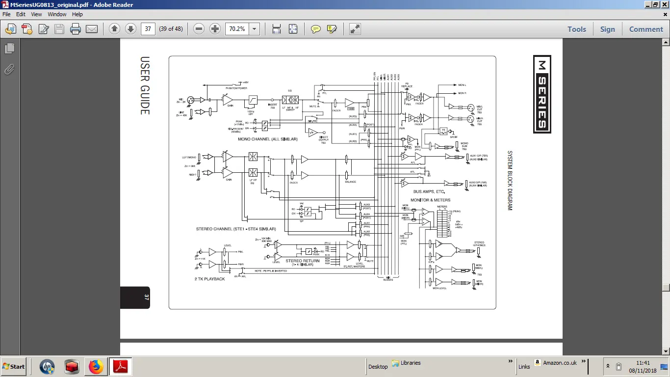

First off, have you downloaded the manual from Soundcraft? If not do so NOW! Then work through it as it contains a wealth of connection examples.
Next. Do you understand the signal flow block diagram I have attached, no? Well, YOU GOTTA! There is no magic formula. Stuff produces AC voltages, most are wee, some very wee and some middling wee. Find the diagram that best suits the process you want to employ and plug up accordingly. Do not worry, even if you get it wrong no damage will ensue.
Things might hum like ***t, or squeal with "feedback" but no smoke will emerge. Keep final output controls at minimum and advance them slowly.
Now, don't worry but. There was a "Spirit" mixer that had a rather feeble power supply but I don't know the mark or Mod number. Might be as well to ask around and perhaps see if a replacement PSU can be found? Rainy day.
