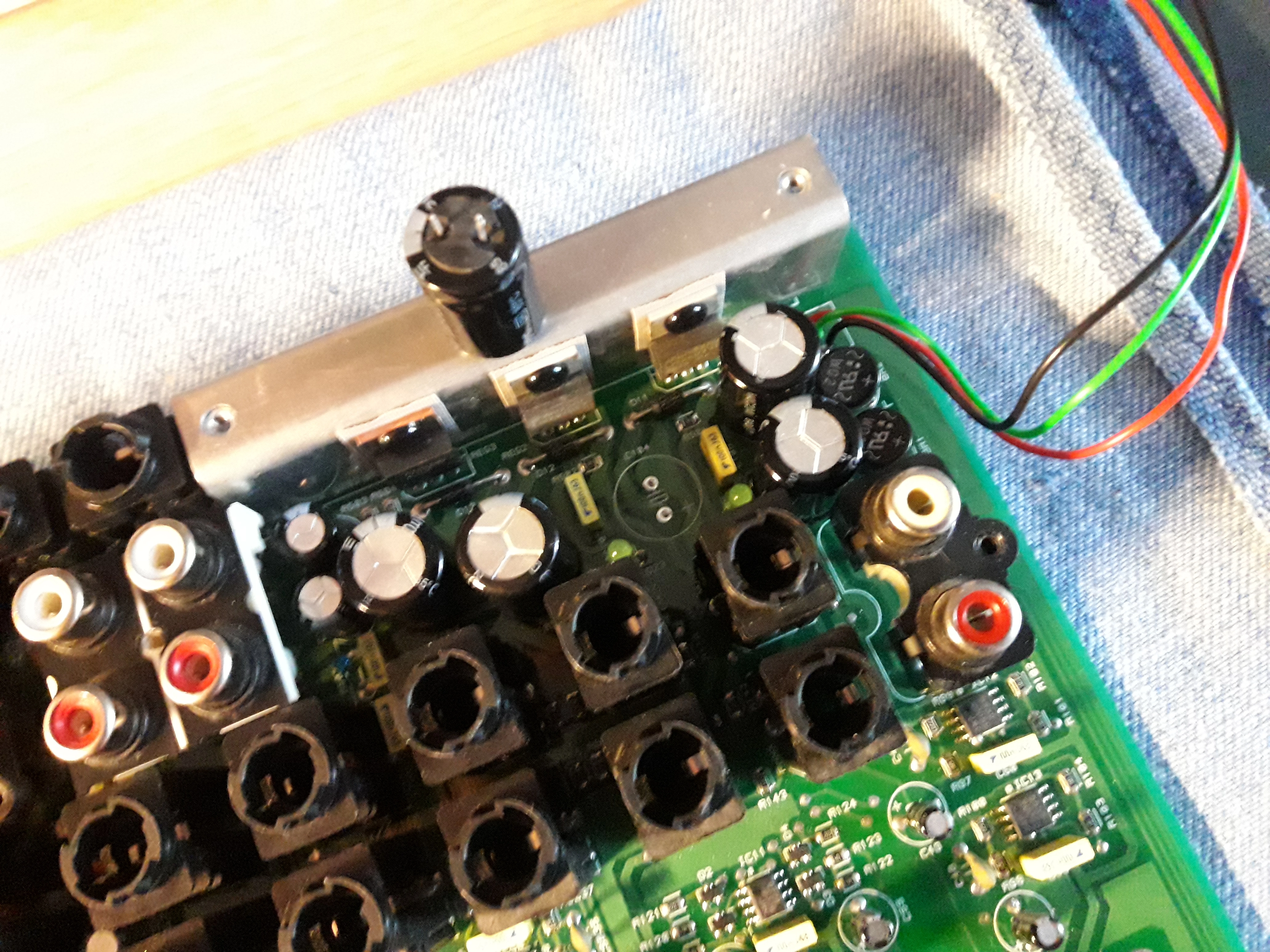

I've been having this intermittent issue with hum in my Soundcraft Spirit Folio SX. A few years ago I had the smaller Soundcraft Spirit Folio 12/2 which developed the same issue. Power supply caps close to voltage regulators that get hot. Easy fix if you're handy with soldering.
Yes, that is poor design but then peeps DO want 'Compact and Beeejew'!
I would be inclined to fit 105C caps if they will fit and a heat shield. Could be Aluminium if made carefully but a piece of fibreglass board would help.
The ones I got were actually 105C.
The original caps were 1000µF 25V, and the rails were at 23,5V. If I've been clever, I would have gotten 35V caps, which would have fit well. I was thinking that maybe it's beacuse line voltage has been increased from 220V since these mixers were made.
I doubt that was the problem. So long as they were good quality caps they would be fine at even a few volts OVER 25V. So long as you don't go nuts caps 're-form' to a higher voltage.
