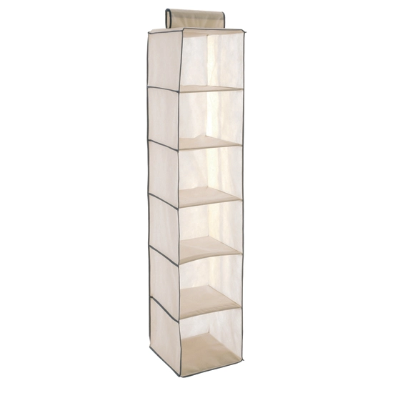

Made sound absorbing panels (2' x 4') using 3/4" x 3" MDF for the frame and 15 bathroom towels laid flat inside. Asked my local Value Village store to set aside all towels that come in but can't be re-sold. They called to tell me they had 14 boxes of them, after a week. FREE! I covered them with something a bit more attractive than towels, and they seem to work incredibly well. Of course, we are just talking higher frequencies. For the bass (traps) I used those cheap, material, hanging storage shelves for closets. I hung them in the corners, about 5 inches away from the walls, and loaded them up with colourful, neatly folded towels. They are almost floor to ceiling. The sound in this room (which has two of the same dimensions...a 'bad' thing) is a tremendous improvement.
