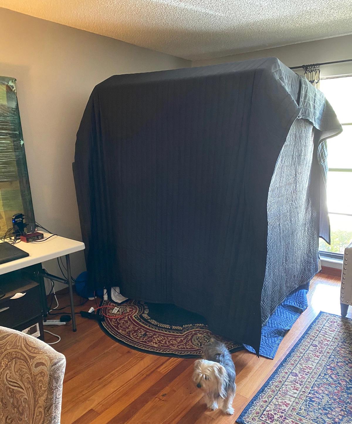

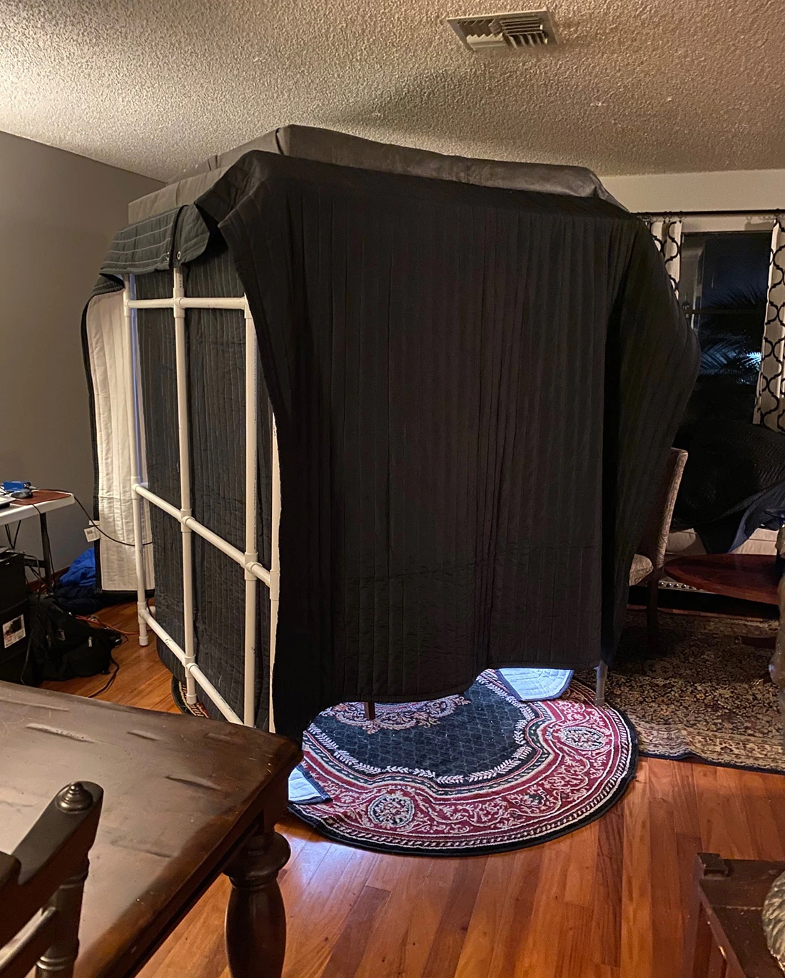

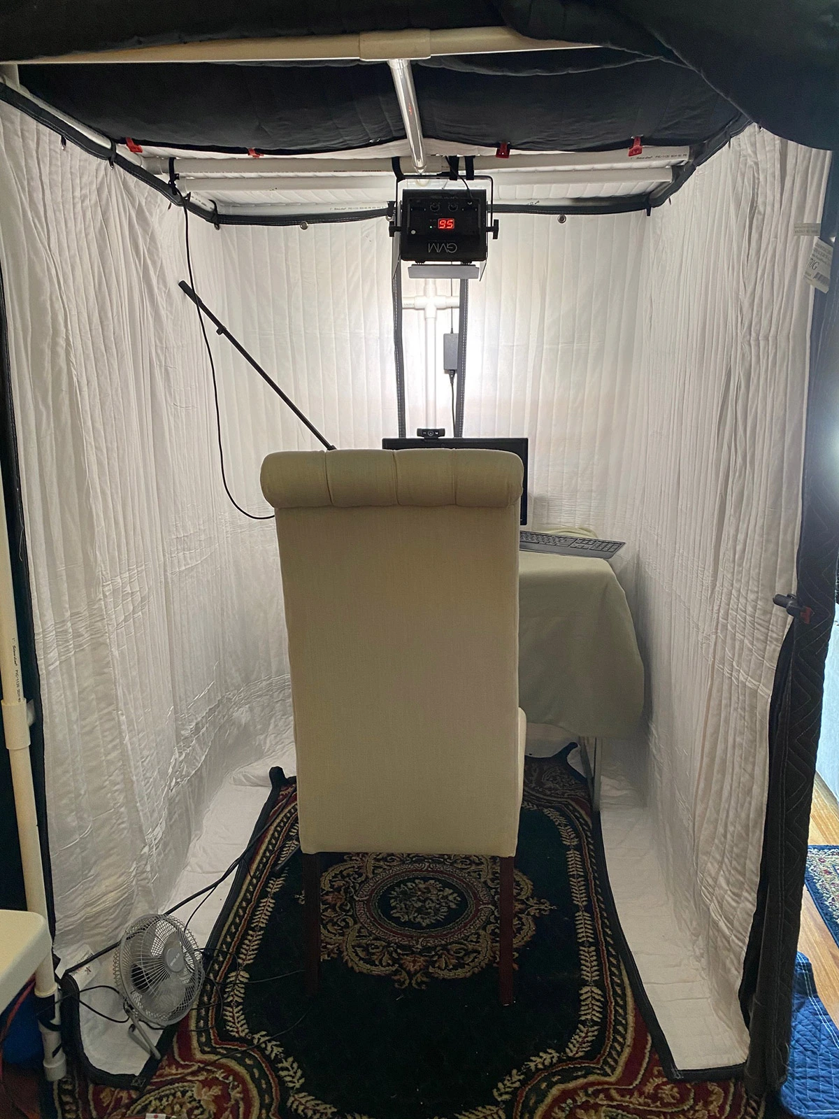

The booth I am troubleshooting is a 54" x 63" X 73" PVC cage lined with acoustic blankets and carpet over hardwood floor. I also constructed five 4" rockwool panels which are temporarily laid against the corner walls in attempt to absorb nearby wall reflections. I've conducted a bunch of unsuccessful experiments over the past few months including placing the rockwool panels inside the booth, loading up the booth with pillows and extra sound-absorbent stuff, relocating the booth in my garage, taking out all furniture and equipment, mic placement, etc...All to no avail!
Attached are pics of the booth and recording environment.

Can I see a monitor of laptop there in front of your seat? You may get a little 'bounce' off a monitor, so you could place it in a position where the sound does not bounce onto your mic and is absorbed by your sound blankets. But a Laptop of pc in your booth is a big NoNo, because the noise from them will ruin any recording. Cooling fans etc.
A shotgun mic will pick everything up in front of it for a great distance. So if you arent in a proper booth there could be lots of noises which you will only hear in playback that it has picked up.
I should hope your cooling fan isnt on while you are recording?

The monitor in the booth is a 12" LCD for controlling Audition and viewing my levels during recordings. I keep the laptop on the nearby table outside the booth. I originally thought the furniture might be an issue as well and experimented with removing everything except the mic, mic stand, chair, and tablet. Basically recording naked. But the resonance and muddiness issue was still there.

I'm gonna try another experiment tonight and move the booth into the center of the room, angle it oblique to the room walls, and place all sound panels on top to buffer the ceiling. That won't be a sustainable solution, but it will at least tell me if the proximity to the corner of the room is contributing to the resonance in the lows and mids. If that doesn't work, I'm fully out of ideas.

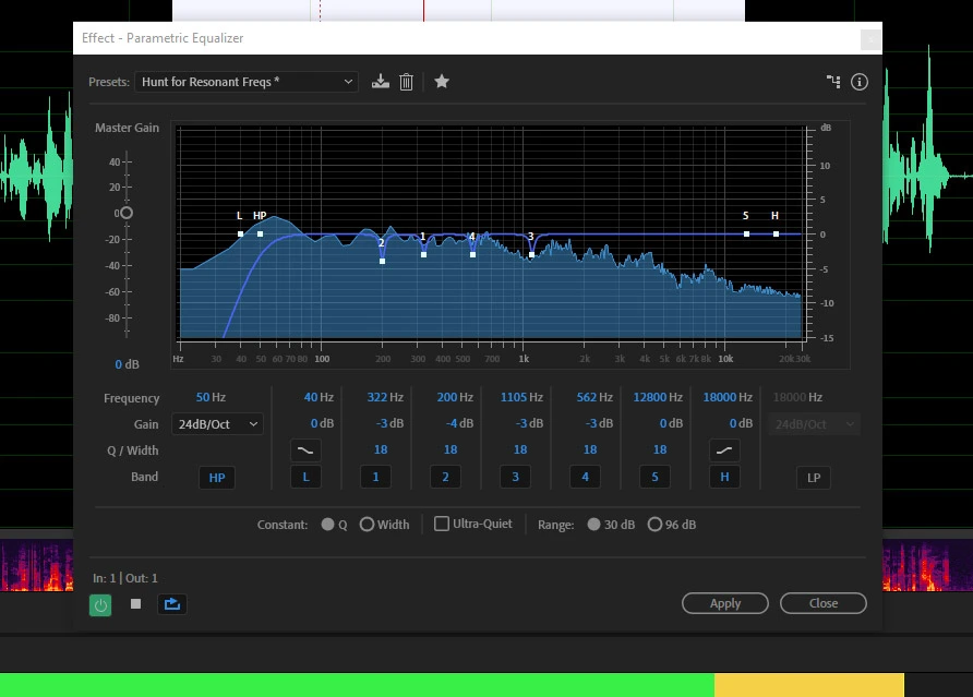

That's what I was observing too. I've been calling them (perhaps wrongly) resonant frequencies. And they are very random in where and when they appear, requiring that I notch EQ every line individually.

I did two experiments last night. One, as proposed by mjbphotos, bringing the panels inside the booth and enclosing them around myself while the booth remained in the corner. That actually had very little effect. The muddiness and pronounced resonance was still there.
Then I moved the booth into the center of the room at an oblique angle to the surrounding room walls. I also stacked all the sound panels on top to catch any reflections from the nearest wall surface (the ceiling). WOW! What a difference.

There’s some resonant frequencies here and there (as indicated in the screenshot below), but they could be easily tamed with -3 to -4 dbs of gain and a tight Q.
