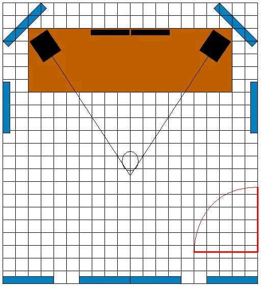

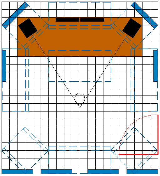

With the amount for 15 4'x2' panels, you could do this...
You'd definitely need a reflective floor though. This might be a little overkill, but it treats all the corners i can think of. Bass frequencies build up between corners, as far as I'm aware, so treating one corner will effectively be like treating the corner across from it, i think :o

sorry, just had to post to panda: I see you have found an animation program!
(your last few pic posts have been animated) - me likey ;)
Yeah i downloaded gimp. I still use paint for the drawings, but put them together in gimp as a gif animation. :D Me likey too :D
