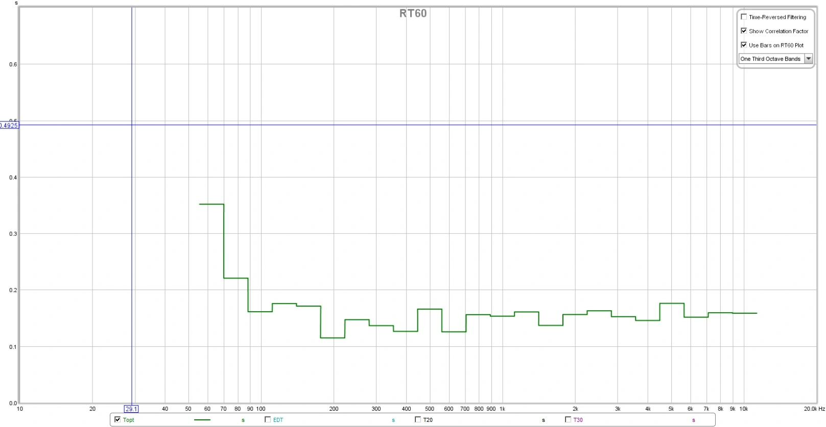

Hello JHB
I see many here that frequent other sites. Anyway, was curious about your RT60 criteria.
(all channels and subs driven)
My room is 8.25'H, 15.5'W. 25.75'D (but with lots of caveats)
Yes, we have spoken before :D
I was especially interested in your comments regarding limp mass or thin walls letting the lower bass (<100hz) escape. My walls are thin, and the room has plenty of places for the bass to escape. Curious why my RT jumps at the lowest reading register.
I see your a pink fluffy fan. So am I :guitar:
My decay, IMO, looks good down to about 45hz. So so great around 40hz :(
Good to catch up with you again.
