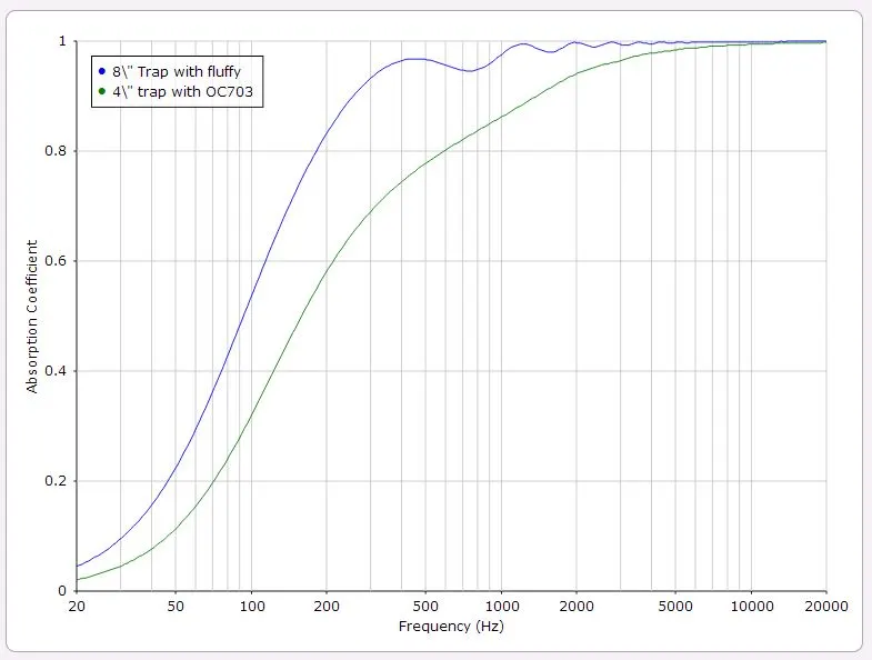

Not understanding that Calculator that Jens linked (got to be an Acoustic Engineer, I guess), would an 8" trap made with the standard pink loose fiberglass (same stuff you put as an attic blanket) be more or less absorbant than a 4" trap made with typical rockwool (OC 703, for example)?
The 8" with fluffy would win. Yes, more absorbent.
