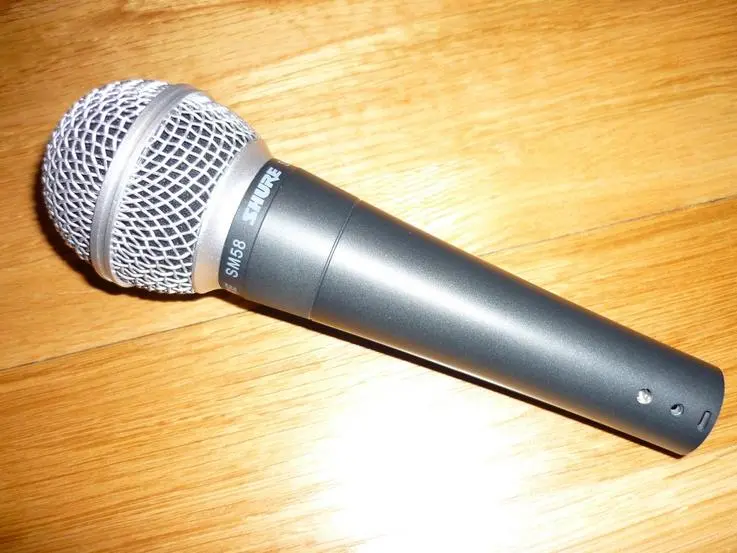

Can you post a good picture here so we can see it?
Oh please, oh please, let it be a real one...
Here are some pics I took tonight moresound. What's the verdict?

Looks like it came with all of the right paper work and accessories. I would say that is authentic.
How about a shot of the XLR side. To see if something is amiss ~ but I doubt that one could tell by just looking at it in a picture.
Nice pictures by the way, right in focus.
Don't know the SM-58 very well, but looking at the picture, is there a screw missing at the connector end of the mic, possibly the screw that secures the connectors?
Thats how they all look, looks genuine to me - out of interest what's om the other side of the cable? xlr-xlr? what are you plugging it into?
