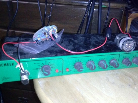

The Joemeek VC6 has an instrument level input which:
A: Isn't ideal for a microphone output
B: Doesn't appear to be available on the audiophile 2496.
I expect the signal will be audible into an inst. input, but it certainly won't be going into a line input.
Also, I'm intrigued to know what the MXL990 circuitry is contributing. Are you feeding it power?
If an unhoused dynamic capsule into unpowered capacitor mic circuitry into an instrument level input is standard practice, it would probably explain the sound quality issues you've been having.
It works for me. I could read no further in this thread. I don't have anything to say to you.
The interface the OP is using has only Line Level inputs. While, he could 'fray' the wires and connect pins 2 and 3, it won't have enough gain unless he screams into the mic. and if that worked, it would sound pretty horrible.
