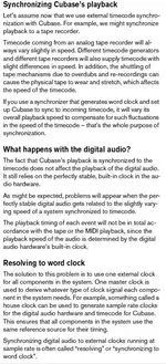

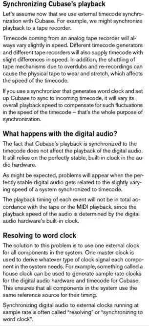

Some DAW's do indeed truncate or augment the sample stream to accomodate the fluctuations. Cubase doesn't. Now you're thinking: "Well what's the big deal then?!?"
The big deal is this...here's how Cubase deals with audio playback...it still locks to an internal clock. Good. Wait...HOW does it stay in sync then? It...DOESN'T. The manual goes on to say that for true syncrhonization with Cubase a central wordclock reference is needed for the studio so that all components can resolve to a central clock. Ummm...including the tape machine...chasing. :eek:
Boy. I guess those folks at Steinberg must be a bunch of idgets.
