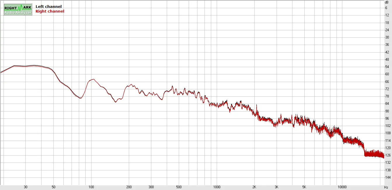

I have attached a spectrum of part of that video clip. There is a huge amount of energy below 100Hz, all rubbish you don't need. I put a HPF in Samplitude at around 120Hz and it eliminated virtually all the "thumps" I could hear in my AKG k92 cans.
I am wondering if engaging the bass cut on the mic is the best option? Allow the mic to boost AUDIO bass (and get close as everyone says!) then put a good 12dB/oct HPFilter or sharper in at 100Hz or so in the preamp chain. This is after all the principle of one form of noise cancelling microphone.
I would also suggest that many studios have a "cough key" to press when making "noises off"?

There is so much unnecessary low end in that signal. That is all I hear is poor eq of the input on the track. Roll that shit down. EQ 101 man.

No idea what a "cough key" is, but for fucking sure that low end needs to be cut out.
