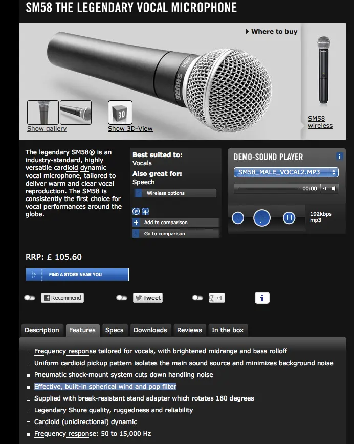

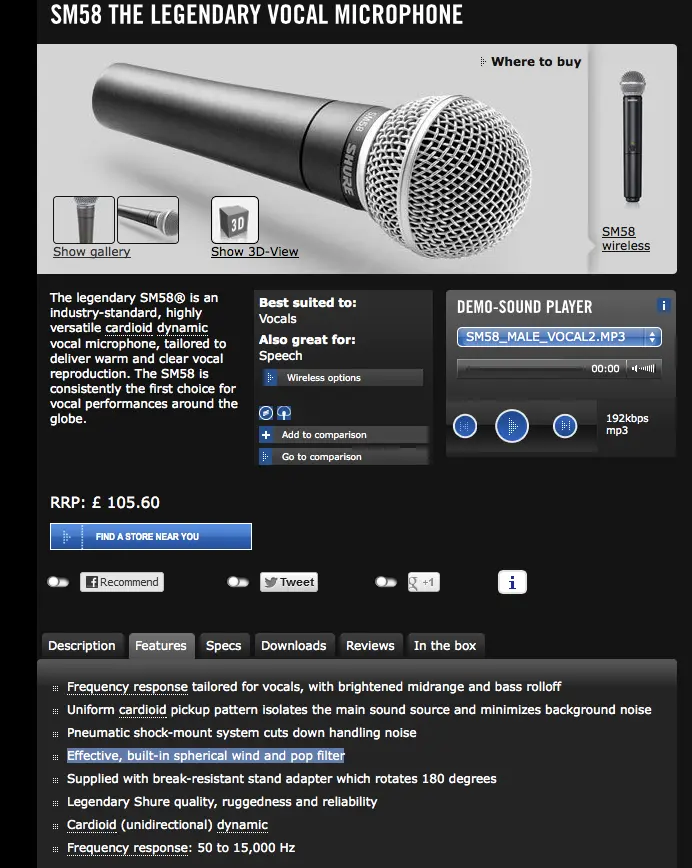

Not sure it matters, but if the singer has dreadful technique and covers the rear grill slot on a 57, it sounds dreadful which you cannot do on a 58. The little foam windshields for 57s can, if out on and taped with a bit of air space, stop some singers getting too close, as they're quite stiff and prickly!
