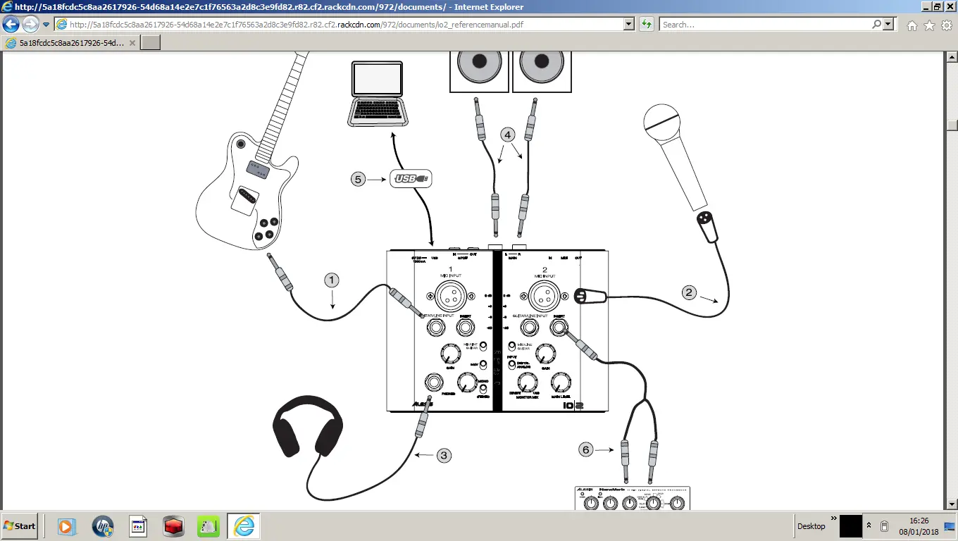

The M Track (the identical Alesis i02 is shown) even uses a separate jack from the mic input.
How the signals are routed inside the AI G.A.Knows, AI schematics are hard to find, but I shall have a do! MOST likely they DO run the HZ into the mic pre.
