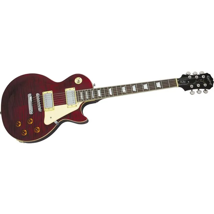

I just got one of those Epi Les Paul Standard Plus guitars in the Wine finish and it's a great guitar-the shop set it up and it's got excellent action and tone. I didn't get a chance for a photo yet but I will definitely post one soon.
Here's a website picture but it doesn't do justice to the maple top...:rolleyes:

thank you for the scoop on the epi lp standard plus,
that is greatly appreciated, I think I definitely going to go out and get one!
