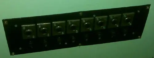

Sorry this is such a terrible picture, the flash on my ********** stinks. This is my patch bay, which has eight XLR jacks, and eight 1/4" TRS jacks immediately underneath - giving me 16 TRS pairs to work for non-standard functions as well as what would be considered the norm - a mic cable :)

Making an adapter is easy ----- one that has an XLR on one end, and a midi/din5 on the other
Yeah...OK...that's all you needed to say...I thought you were doing something else. :)
But if you have the MIDI needs...why not just add a MIDI jack to your panel?
That must be one ugly looking adapter!!! :D ;)
heh-heh, just trying to share as others may find this usual.
Mostly because chassis-mount midi jacks are cheesy and not durable. XLR jacks can survive many connect/disconnect cycles whereas every chassis mount midi jack I've bought has fallen apart fairly quickly.
