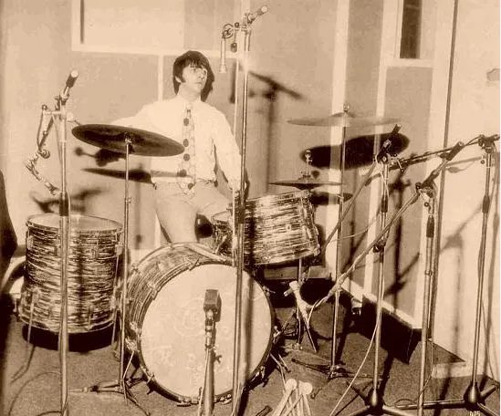

You start with the Drums used and the drummer playing them, then the mics and the micing technique. I actually own a Ludwig kit the same vintage as Ringo's that we use as a studio kit.
Well, the attachment did not attach so here is a link.

That is a pretty awesome pic. Looks like Ringo is using EV 635s's as overheads too!
That is a later picture when they started to mic up the whole set. Not so in the early years - one microphone at best.

This attachment thing is killing me! Here:

There was a much better drum sound on the later albums when they started using more mics (like the picture), however the early albums had a great drum sound for the time compared to some of the other recordings around the place.
