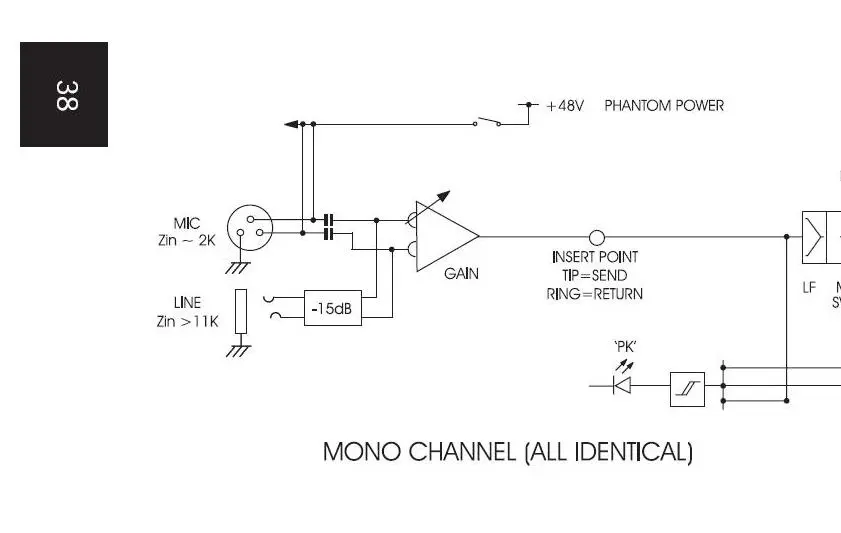

With Soundcraft E8 the phantom current shouldn´t get to the line inputs
which you would use with an ext. preamp.
