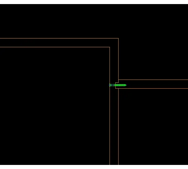

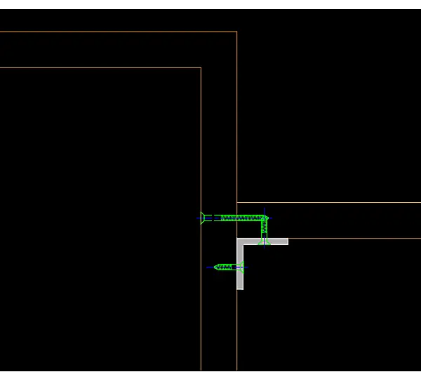

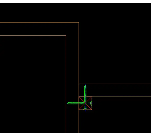

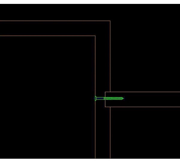

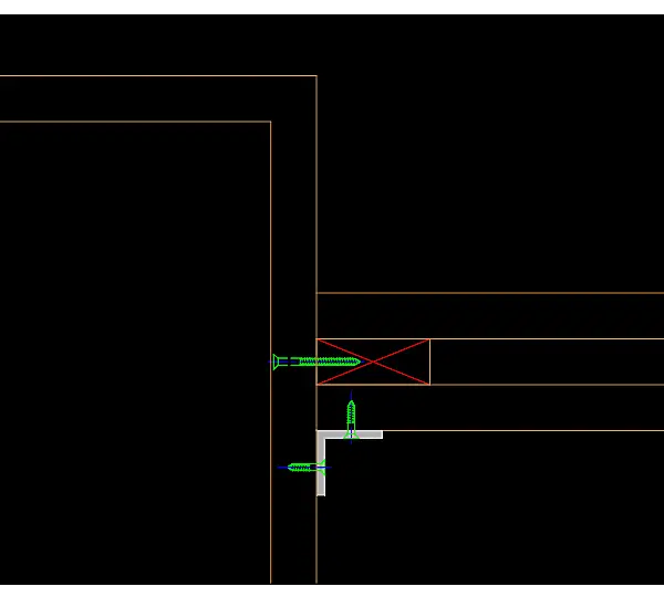

Trying to get a visual of how I need to connet the main table to the sidecar. The front will be even with the top of the desk.
Hello dcwave. For not woodworking for so long, looks like your doin great.
Heres a few tips on fastening your deck to the sidecars. There are many variations. Another thing, you might need a strongback(angle iron or wood stiffener) under your deck if it has a long span with heavy weight on it. One of these joints is a doubled deck. I do this for extremely long spans with no stiffener. For finishing, laminating is cool, but unless you have a router with a flush cutter, its very difficult to trim once laminated. You could file it...naw..just prime it and paint. Thats what MDF is good for. Personally, I like Lacquers. EASY. Even spray cans. Always spray a sanding sealer though, and sand lightly between coats. 220 usually works best. Lacquers come out nice, and their durable too. I'm not too keen on latex for fixture work, although it has its place.
Anyway heres some joints.
