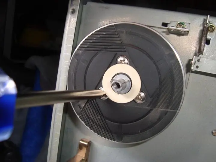

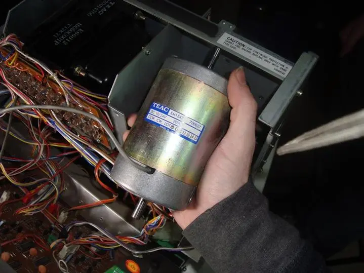

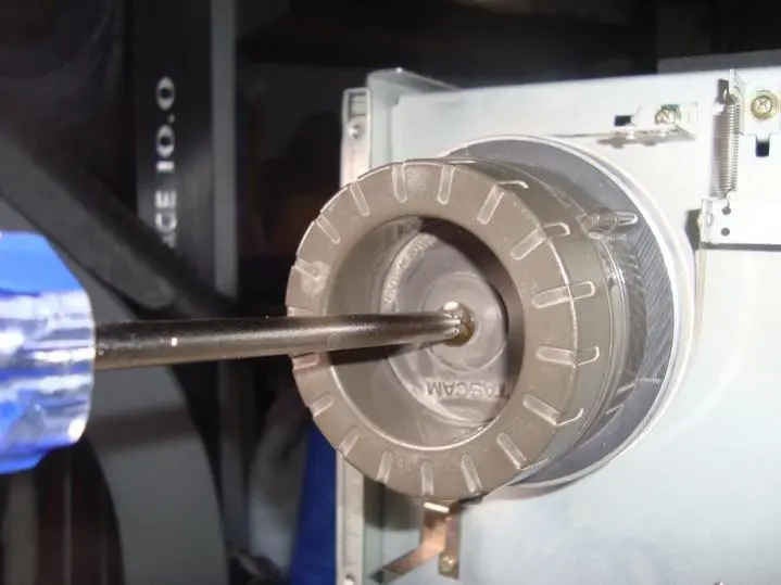

Remove the Clamper Reel Hub from the machine
Remove the three screws on the Table Assembly Reel and remove

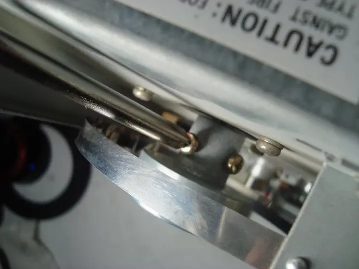

Loosen the screws on the Base Assembly Lifter and remove the lifter

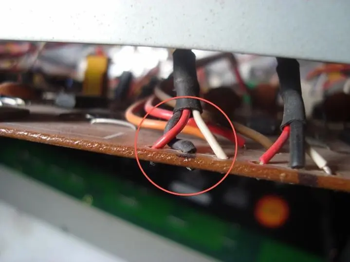

Desolder the motor wires from the PCB

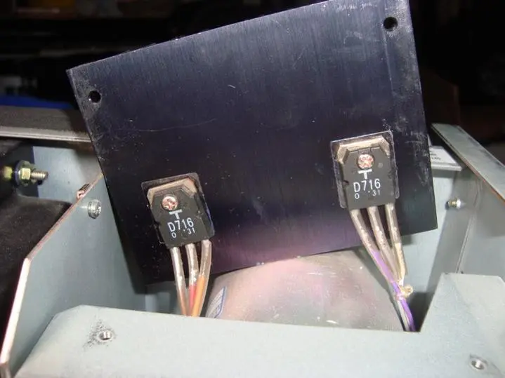

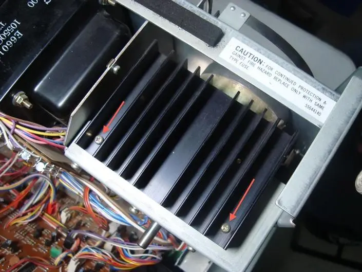

Remove the Heat Sink
Transistor/s from the heat sink. (don't loose the plastic spacers beneath the transistors)

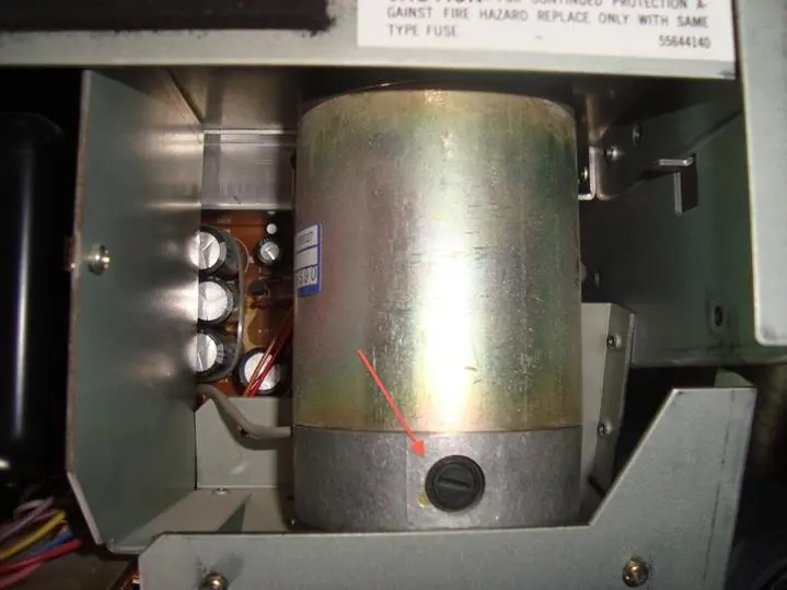

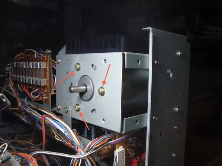

Remove the Motor Mount Screws
Remove the Motor Screws (front & back) to remove the motor from the machine
At this point, you should be holding a marooned Reel Motor!

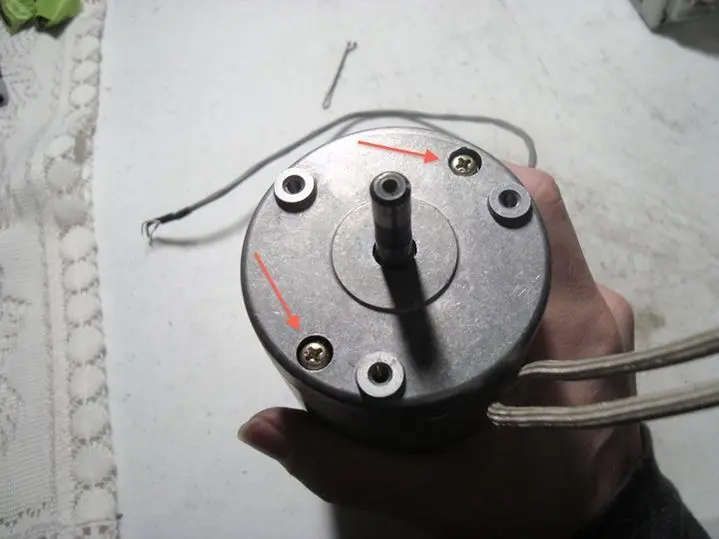

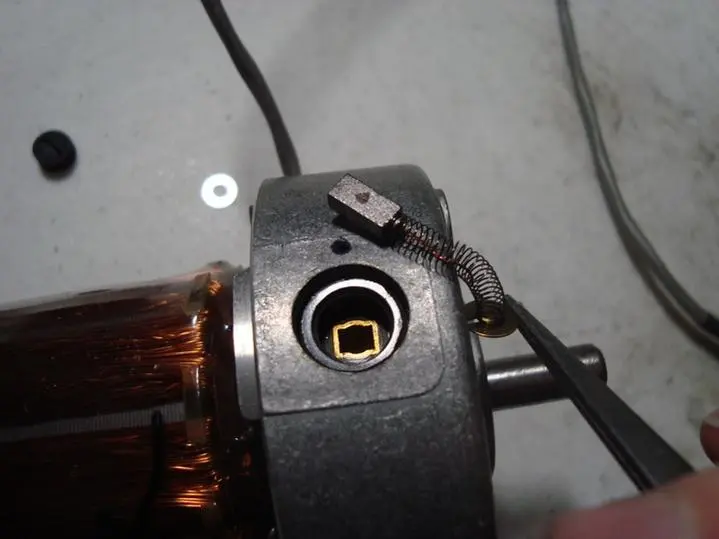

Lets remove the brushes!
To do this gently unscrew the black inlet screws to expose a washer and the motor brush.
Make sure you make note of the orientation that the brushes are placed in the motor, if you put them back in a different way, they will "re-wear" and clog up the motor again from new wearing and friction. (I use a sharpie marker to make a dot on the motor and a dot on the brush to match up. One dot on one brush, two dots for the other)

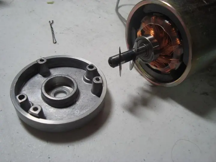

You are now free to remove the two long bolts to get the caps of the motor off
Great, We're in!

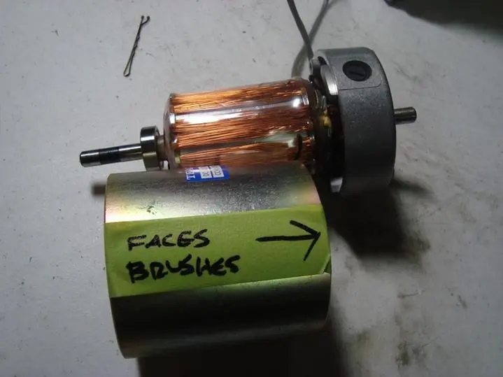

Just to ensure I put everything back together properly, I put tape on the motor shroud to signify the direction in needs to be in. (Better safe then sorry!)

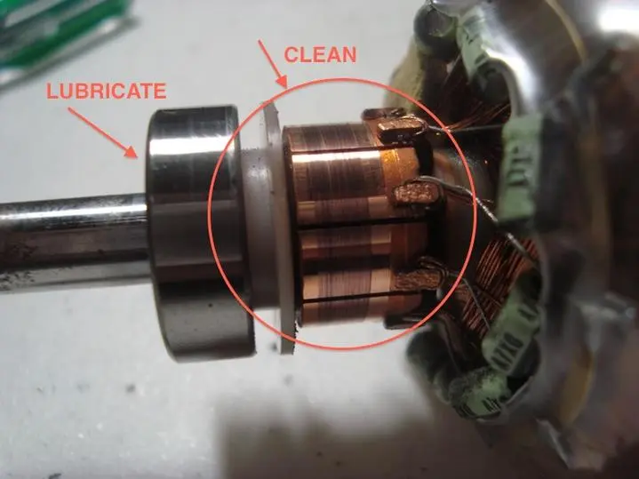

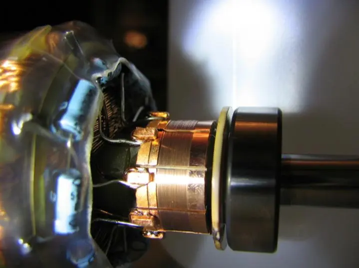

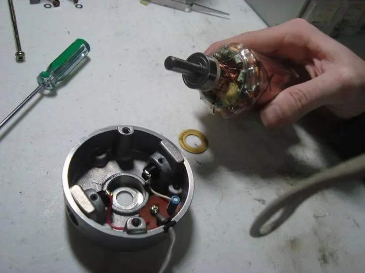

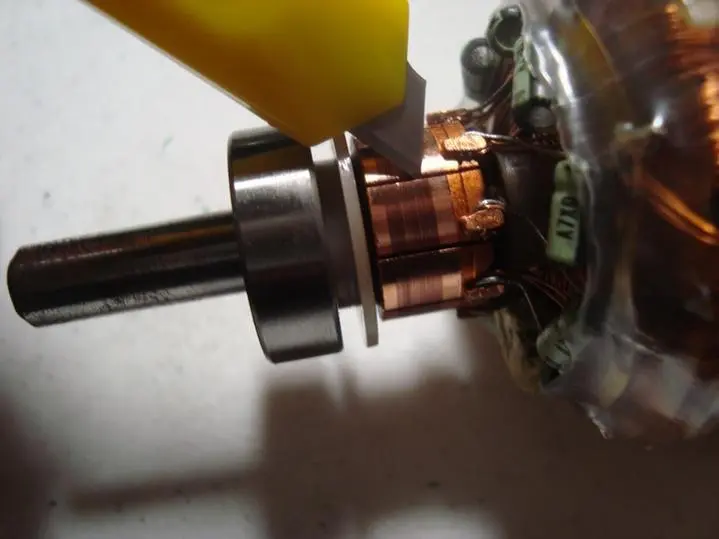

Now, clean ALL of the black shedding and crap out from the motor covers, the shaft, the bearing, washer and the commutator (the bronze thing) Make sure to lubricate the bearings, better would be to completely remove the bearing for a more thorough job.
I use an old toothbrush and Q-Tips and 97% Isopropyl Alcohol to clean everything.
I use a razor blade to clean the grooves of the commutator

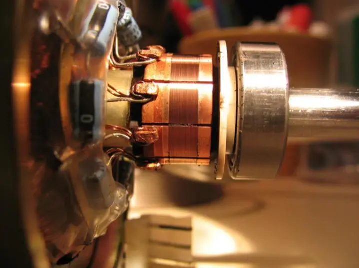

Here are some photos SweetBeats posted for a similar issue to illustrate a proper before and after. (Please remove these if I am breaking a rule - I didn't think SweetBeats would mind.)

they should come out easily, try heating them up with a hair dryer and gloves (so you don't burn yourself). One more thing, don't use alcohol on the bearings, that will ruin them, the alcohol is for the metal copper contacts. You can replace the bearings if you want too, they can be found online, if you do, use ABEC 3 or higher bearings (size accuracy spec).

Hello friends! So good to read this as I service my 58 motors, thank you for the great info. I have a Q!
The stepped nylon washer between the commutator and the bearing has completely deteriorated on one of my motors. I’m really struggling to find a replacement! Does anyone have any bright ideas? I’m in New Zealand so ideally could find something local.
Has to fit on the shaft (M8) while the raised diameter is small enough to not touch the outside of the bearing (~9mm), and the diameter shields the commutator (~22mm) and it should be about 2.5mm high. Pairs perfectly to the bearing size (608).
Does it need to be stepped? I.e can I just have a flat 9mm washer that’s the right thickness? Or is it important to shield the commutator the way the og part does?

I missed this thread when it was originally active. Good job to the OP with all the details.
To the question at-hand, YES the washer needs to be a stepped shoulder washer. The reason is that washer must only come in contact with the inner race of its adjacent bearing. It must not contact the shield or outer race. There are spring washers in the motor end cap, and the loading those springs create must interface only the inner race of the bearing. This affords proper pre-loading of the bearings which ensures mechanical stability in the assembly…longer life and quieter operation…it is essential. I don’t know for sure the washer needs to be nylon…that may have been done for damping. Aluminum may be okay as well, or brass. But the correct nomenclature for the part is a shoulder washer, and there are places that have a ridiculous variety of them…try McMaster Carr.
A couple other points: if you’re replacing bearings, I would not just get any “ABEC-3” bearing. I would take any ABEC-1 bearing made by Nachi, NSK, Fafnir, SKF, etc., over a generic ABEC-7 bearing even. YOU GET WHAT YOU PAY FOR. I’m speaking from experience both working in a machine shop and working on tape machines including my old 3M and Ampex professional machines, which were made in times when the engineering standards were much, much higher. So I admonish everybody to go with name-brand vs paper spec, because I’ve tried both…gotten the highest quality generic bearings from vxb.com and they were garbage compared to a NOS set of Nachi bearings, for instance. The generics were mechanically very noisy, the Nachi like silent glass. Also, don’t get metal shielded bearings in a motor with brushes. You need RS (rubber shield) bearings in a motor like these, or even rubber shield on one side, metal on the other (yes they can be found in that configuration), and face the rubber shield toward the commutator (at the nose bearing) and the windings (at the tail bearing).
Lastly, I often see reference to “lubricating” the motors but that not fixing the problems (of noise or whatever)…these motors in the machines we are talking about have pre-lubricated shielded cartridge bearings. DO NOT oil the assembly. You’ll only send lubricant all over the commutator, brushes, windings, etc., which are not meant to be oiled. If the bearings are shot, they are shot, and should be replaced.
