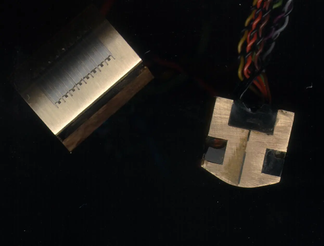

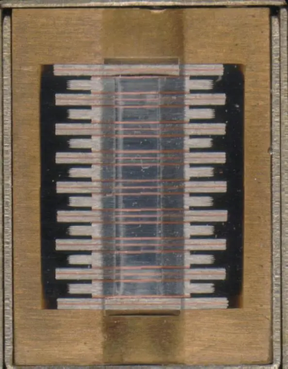

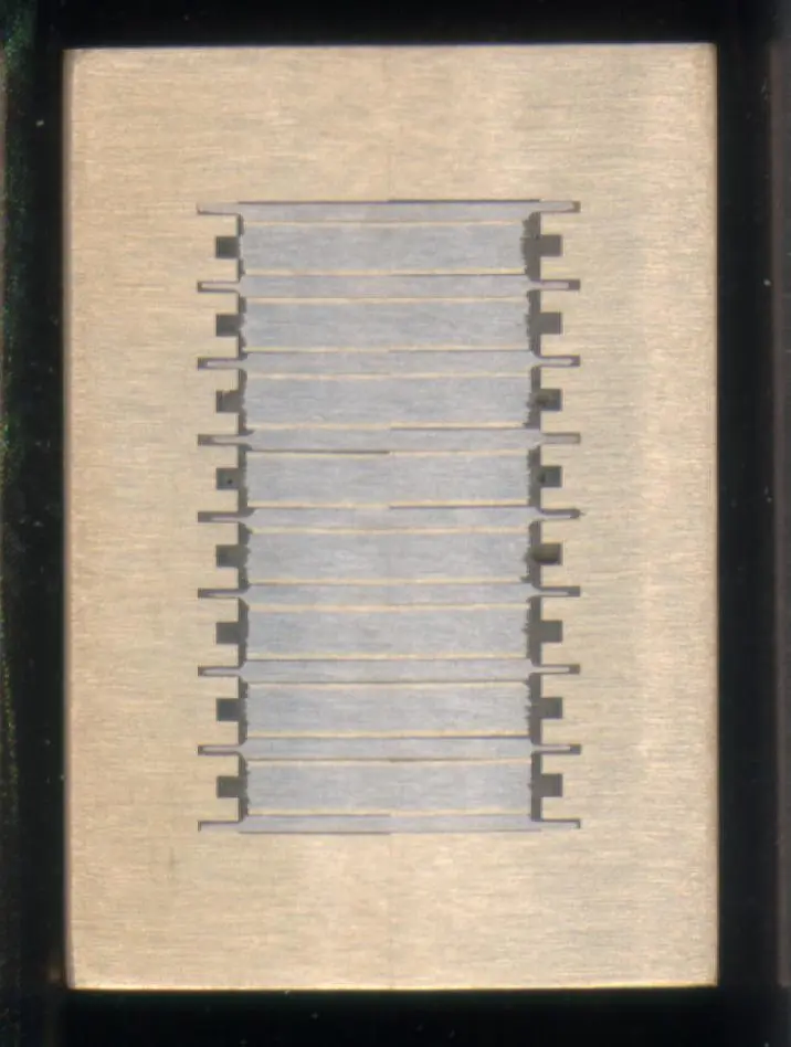

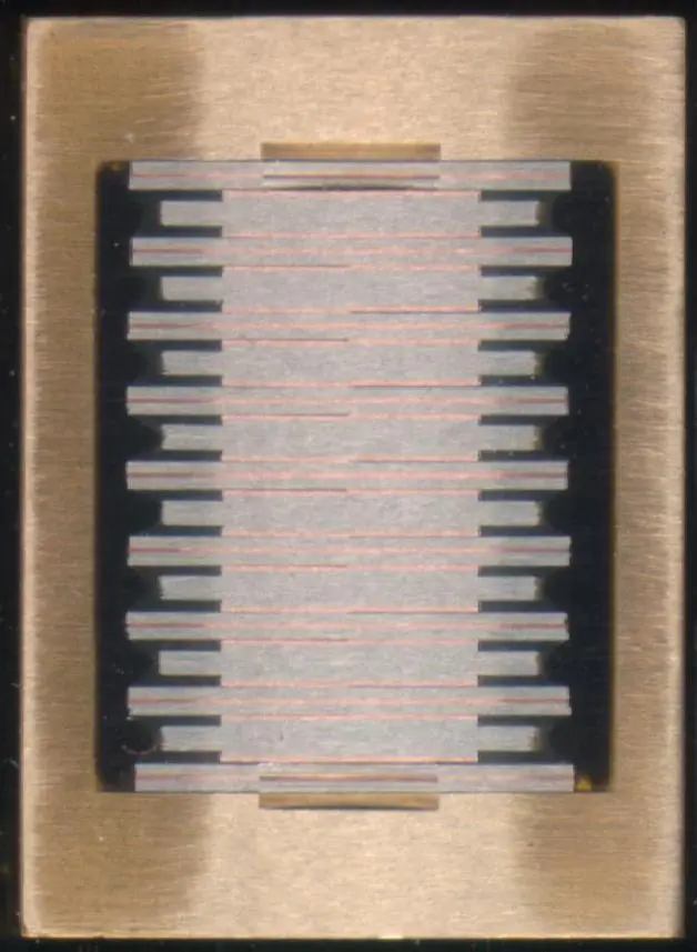

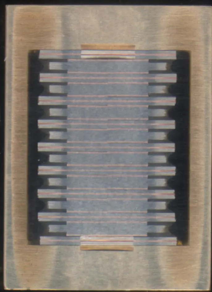

... Finely got around to trying my hand at lapping a few 8 track, 1/2" heads that I picked up a while ago. Not sure which deck they come from. The headstack base is like that of my 38. All 3 heads are brass based like the rec and repro. The wires go to phenolic PCB rather than a header like the 38. Anyone know?
Here are 2 photos of the rec/sync head. A before and an after. Looks like a usable head. When I get the time I'll open up the 38 and pull those heads. I may build a header and try putting one of these heads in.
OK here goes: I did this on the kitchen counter, rinsing the sand paper and head frequently. Starting with 400 grit wet I followed the Norinco instructions to remove the keystone and establish a nice profile. Once the flat spots were all gone and things looked good I moved on to 600 grit wet paper. This took much less time to remove the 400 grit marks. When I thought there was enough of the 600 (perhaps 10 minutes) I moved on to a 1500 grit paper. I took another 20 minutes or so with this. I took extra care to not mess up the work that I had already done.
One thing tha I did do was to rotate the head 180 degrees at every rinse. THis was to make sure that my hand pressure was equal on both sides and top to bottom. I wanted whatever weirdness I was doing to cancel out.
The last photo shows the side of the heads. You might notice that the brass/epoxy at the head face might show the gap depth. Not sure of the construction inside but it was about 20 mils before I started.
Oh, I did use a caliper to measure the wear depth and came up with about 7 mils. It appears that theblown head on my 38 has a wear depth of 20 mils. This is consistent with the 20 mil gap depth figure that I've heard. wore later when I get it our and try a relap.
Regards, Ethan

Very nice work! Hard to see the contour of the head in the first two pics, but the last one certainly shows off that beautiful curve. :cool: :p
I agree...nice work. Too scary for me yet, but I may have some spare heads here depending on what I do with my "parts or repair" 48.
That head reminds me of a Fostex E16 head...no edge slots.
I might even tackle that if there were no head slots but my deck has them so I'd be freaked about wrecking it. Nice work tho'.

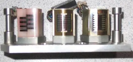

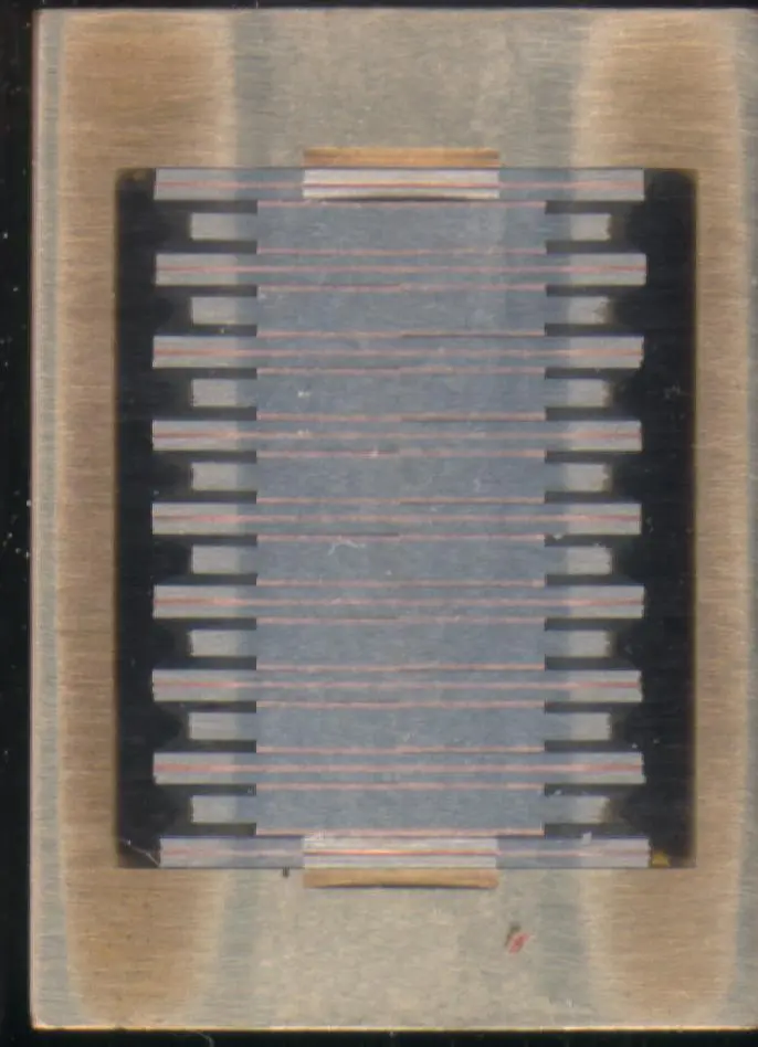

Pulled the 38 headstack out
Starrting to look at the 38s headstack. This photo sucks....
However, the sync head is a newer head than the repro and erase head. Looks like I suspected. The sync head appears to have about 5 mils wear and the repro closer to 15. the color of the brass is different as well as the locktite.
the photo does show the pronounced flat spot on the repro head but does not show the places where the gap is blown through. I'll get some better photos later.

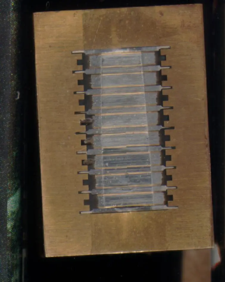

Repro head test lap

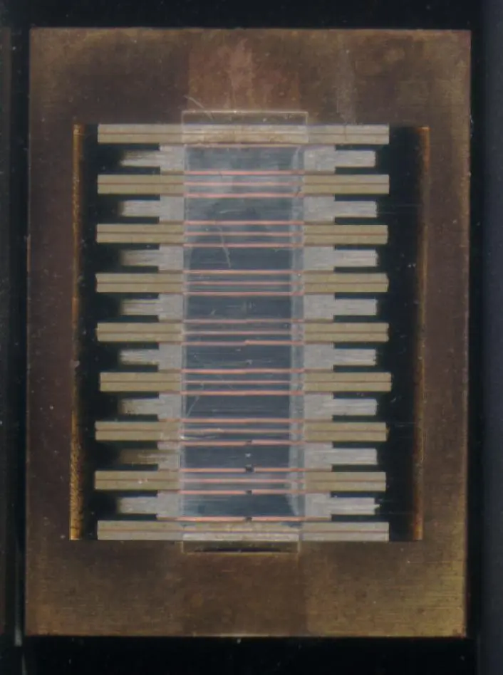

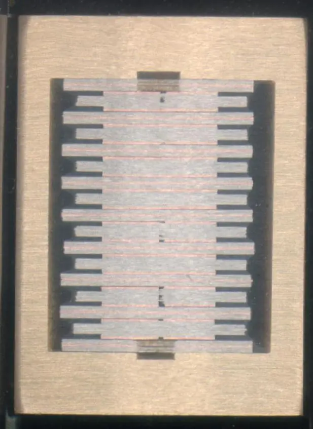

Popped the repro head out. Remember that we know it is toast so this is a learning experience. Once you get the head off the base plate you can push it out of the shell. This head had about 18 to 20 mil wear and a pronounced flat spot. Looks like it has never been relapped.
Here is a photo before starting on it and one after 400 grit shaping. Notice how the already open gap open up more and in more places.... Also, notice how the edge relief slot has gotten smaller due to the amount of metal removed.

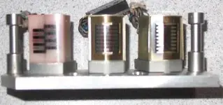

I picked up that TSR-8 headstack the other day. The erase head from it is less worn so I will swap that in place of the original. Wear here is in the plastic. I'll post some side by side later.
The TSR-8 rec/play head shows a little keystone and not much wear. Side by side with the 38 sync head they look to have about the same wear.
The question is to re-lap or not? I cols go either way. The pro for re-lapping is that the heads are not as smooth as I would like. The con is that this is the real thing. Mess up and I'm out $. But then again that is what all this trial and error has been about.
I think that I will get some measurements of wear depth and then decide if I want to re-lap (round the nose to tale out the flat/keystone) or polish with 30u then 9u lapping film. Or just leave them alone....
Let me know if this gets boring.
-Ethan
PS 38 is the first photo

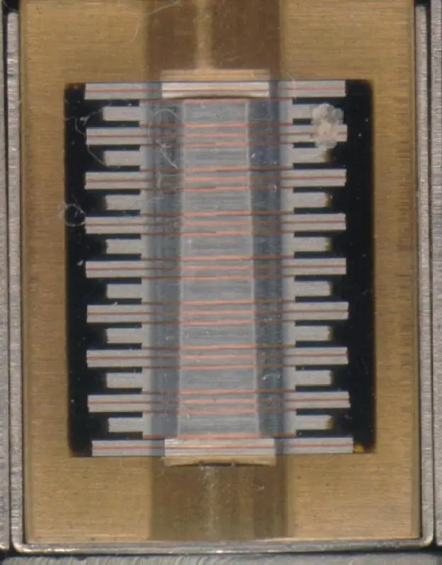

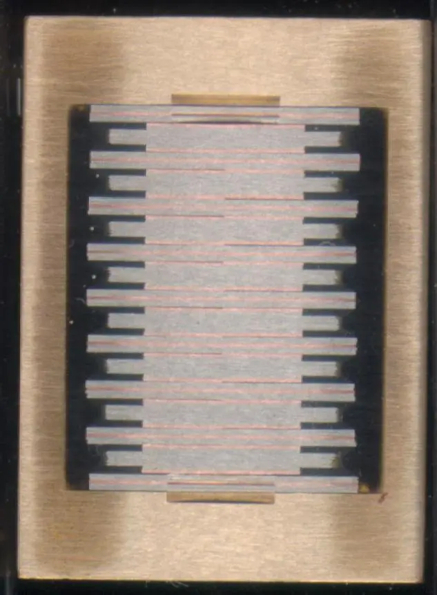

OK, So I thought why not get rid of the keystone and see what you get. So I did.
There was only 3 to 4 mils wear so I started with the 600 grit rather than the 400. I figure that it would be less metal removed to smooth it out. It only took about 10 gentle minutes to shape the head. Note: this time I reshaped only in the nose area.
This came out very nicely. As you rotate the head looking at a reflection of a light you will see the reflection flatten out in flat spots and in general star a tight line in the curved areas. this tells you when you have the flat spots out. I rotated the head 180 degrees so as to be sure that my hand did not intoduce a bias. First photo shows the results.
Moving on to 1500 grit I again tried to work only in the nose area. 1500 is for removing the 600 grit "scratches". Another 8 to 10 minutes here with lots of washings, rotations and inspections. Won't actually get a mirror finish but it will become reflective with a hazy image. Photo 2 shows. hard to see the improvement but it is quite visible. Feels smooth under a finger.
Next is 12u lapping film (3M yellow). It might have been better to start with 30u lapping film but none here today. Just means more work. In a lapping file the abrasive is bonded to a mylar sheet. You can use quite a lot of downward force. Clean often and move to a new section when it loads up too much. You can feel if it is cutting. Now the head starts to take on a mirror finish. And it gets a silky feel under your finger. Photo 3.
Last is 9u lapping film (3m blue). It really did not take too much more time to put a nice shine on the head. Feels very silky. From the photo you can see that I ended up polishing outside the head. Quite sure that that is not a problem.
Regards, Ethan
