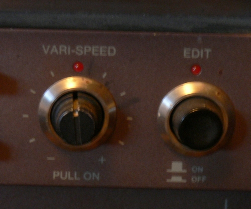

I don't see the knob and all they say is tape speed, which is not speed control +/-
But what's varispeed got to do with getting tape saturation...?
I mean...you're going to choose a set tape speed, tape formulation, calibrate and set the bias and then decide how much to saturate the tape with the input signal.
We're talking about plug-in emulations of tape saturation, right...?...and not of the entire tape deck operation. :)
I've not heard of anyone varying the speed in connection with the saturation they were going for.
For pitch adjustment and other effects...yes.
