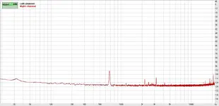

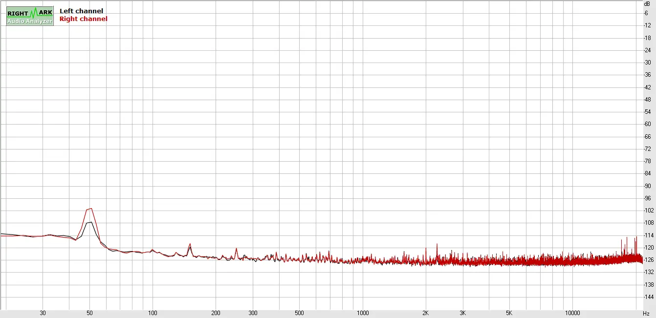

Mind you! The spectra of my 202 shows no great spiky artefacts? Not pristine I grant you but I believe any noise from the 202 would be well below tape noise from the B77?
Noise specs of the latter give -67dB for 1/2 track at 7.5ips, can we allow -70dB at 15ips? Very good of course but they are A weighted figures. My tests of the 202 gave -78dBFS with the gain at 100% in Windows. Back that off to a more reasonable 10% and the noise improves to -84dBFS*. UNweighted. Can we say at least -80dB and around -90dB A weighted respectively?
I don't have a B77 (slurp!) but I would bet a UCA202 would make 'transparent' copies of such a machine. However, one problem would be the lack of input headroom of the converter. Max in is about 1V rms and I think the B77 can easily exceed that? A pot in a tin is easy enough to arrange.
*If I can find a mo' I shall see if I can find an optimum gain setting for the Berry box. BTW my current device is actually the UFO202 with the RIAA/line switch but as you say, they all use the same "engine"!

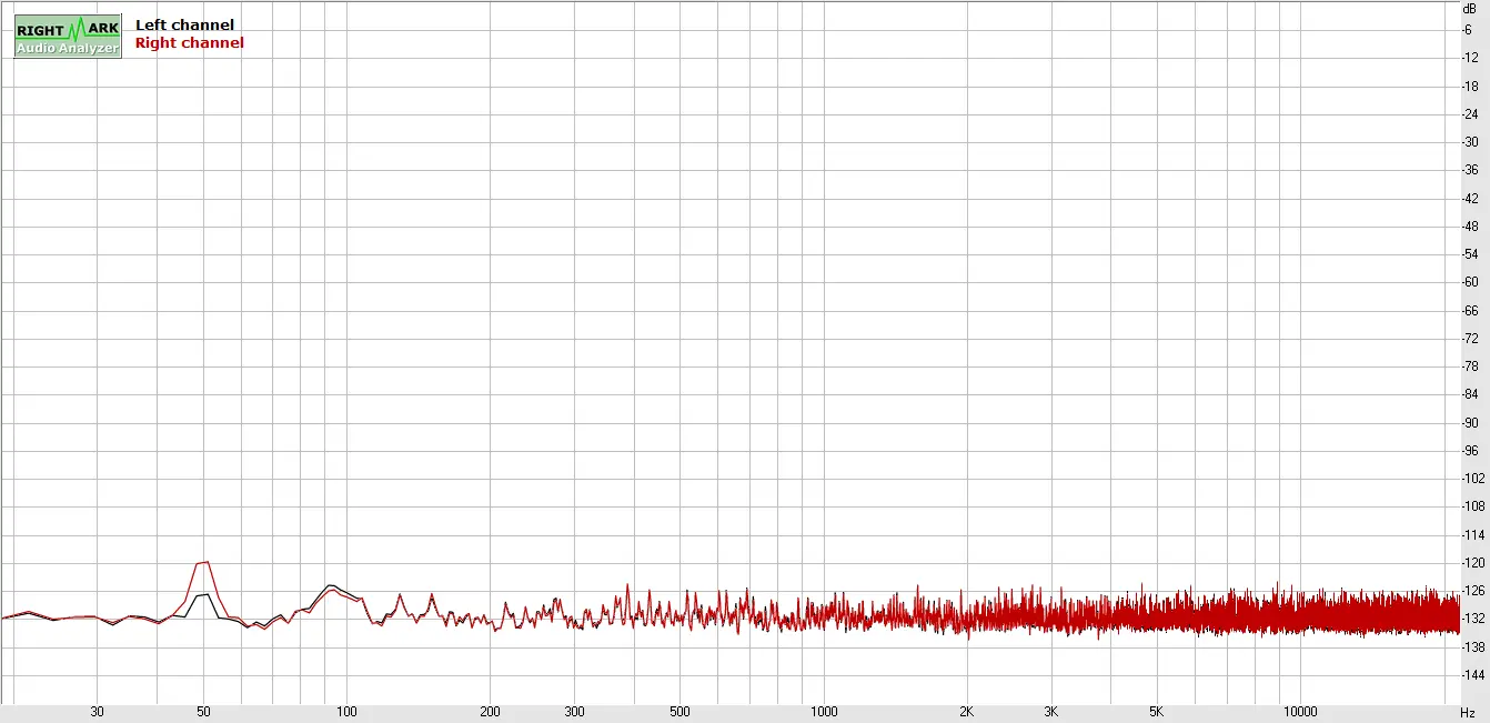

If you want to know my MO for recording the 202 noise? Samplitude SE8* and just ran for 30 seconds with the inputs O/C (where the 50Hz blip comes from shouldn't wonder! I set the recording level in Win 7 Sounds to 100% and 10%.
*Yes! I DO have Prox 3 but the meters in SE8 can be set down to -90dBFS, a feature they seem to have dropped in later incarnations?

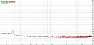

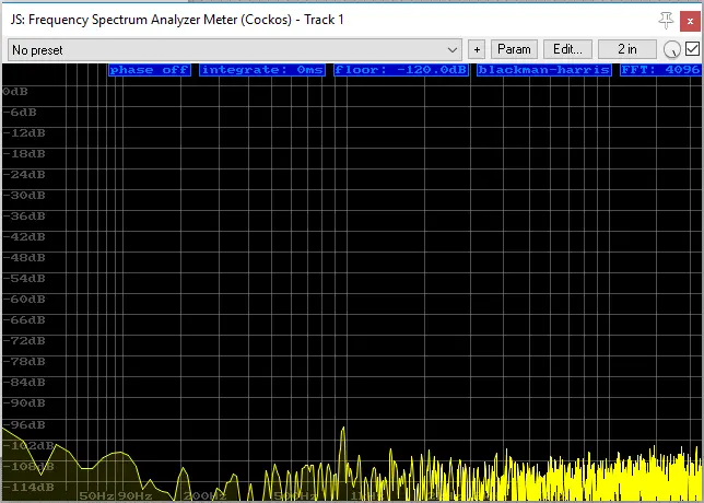

Hopefully the picture below shows an instantaneous analysis for my UCA222 - there's an obvious tone just below 1kHz in that picture although the actual frequency varies over time.
And for comparison here's a section of blank tape through my studio convertors with the same settings on the spectrum analyser (albeit sampled at 96kHz).

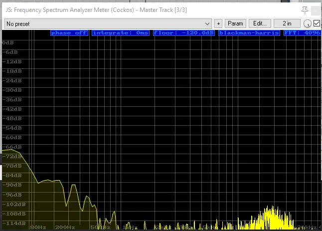

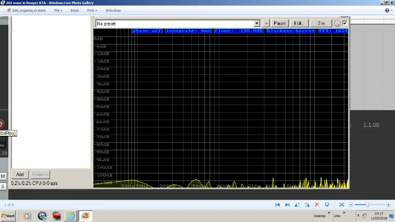

See the spectrum of my 202 in Reaper RTA James? (took me a time to find it. Don't use/like Reaper!)
No spike at or near 1kHz but in any case my point is that if you set the gain of the device low enough in Windows the programme noise, especially tape, will mask any artefacts?
I agree however, the 202 is borderline good enough for the job. I have to say...You can see from the other plot how tape EQ (NAB?) screws the noise spectrum especially at LF!

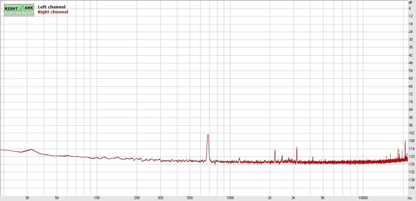

It's a bit more complicated and insidious than that Rob. See attached the spectrum of my zed10 USB (gen 1 16bit. All chans 0, main out at '0' 2o'clock) There is a spike at a tad under 700Hz and well below "100dB"? Not in practice. The actual noise floor about -85dB and so that spike is clearly audible unless masked by other noise. Even for tape it might be intrusive.
The "fix" from A&H is to set the PC recording level way down to 5% and hit the converter harder. That works ok for noisy band jobs but not acoustic guitar in a Npton leafy suburb at 2am!

Remember that the second plot in my post is the actual noise from a silent section of reel to reel tape (30ips with IEC eq). If I'd used the Dolby A decoder it would have been even lower. So that spike is well above the noise floor from a good analogue tape and certainly audible on quiet material.
The point that I'm trying to make is that a Revox is a decent machine that deserves to be partnered with a reasonably good a/d convertor.
