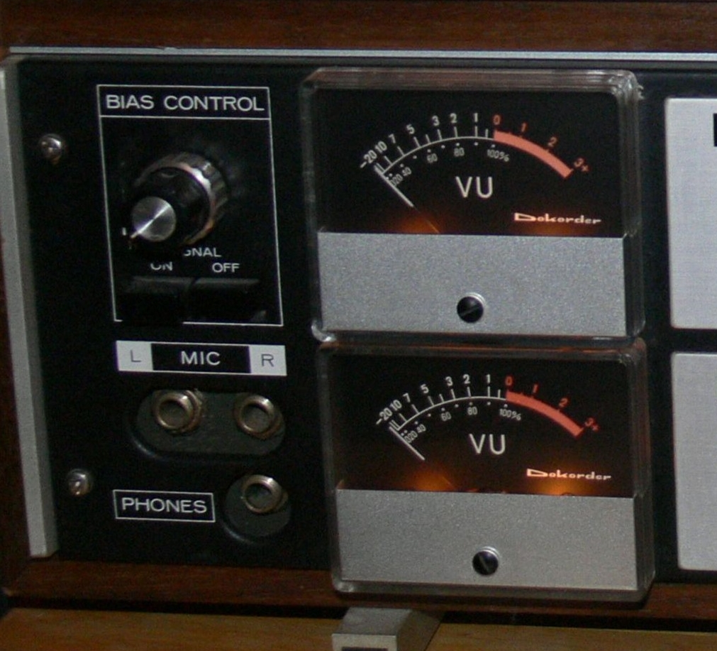

Ya, the VST mfg invented another whopper : ) At any rate, there can be many ways to tailor distortions on a tape machine
