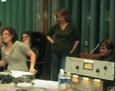

The vocal track articles interest me the most currently...the mics, the pre's and comps used on various songs.
Its crazy from SM7, to U67 to SM58, to MXL990 all on Billboard hits. Why Neve, API, became so sought after? or the 1176 or LA2A? Distressor ?
I think "leave Comp for later" is a wise way to record (CLA) but many slap the comps on during tracking (Al and others).
The hall-of-fame Neve73 pre to the 1176 or a LA2A with or without the Pultec eq...channel strip. Or a SM7 into the Pre/Comp is common.
If I was serious on something my Line 6 UX8+ PodFarm software allows both Dry and Processed at the same time by simply selecting which channel in Reaper. Ex Track 1 can be DRY and Track 2 can be processed, or I can select stereo processed etc...about any combination. Best of both worlds.
But getting a great mic and preamp is the "dry" sound which isnt always dry?, as solid state clean vs tube-ish vs transformer vs tube+transformer etc.... when CLA mentions tracking dry it might be a U67 into a SSL board or Neve and probably not a ProTools MAudio preamp on the interface.
this has preferences on Vocal tracking by some pro's-
Recording Vocals | Mixonline
