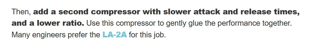

Put the compellor as first compressor. Generally the slow, gentle one is first, and then a fast compressor is second. Fast and infinity to limit.

I was thinking like 2-5:1 ratio subtle , then spankin it to infinity with a second.

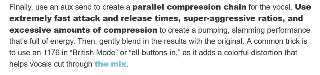

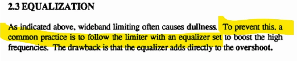

Oh.. Well, I used some examples showing how some professionals are using these products in modern music.No, I mean a channel of compression for each track. So for a duo with two vocals and two instruments, that's four channels of compression.
So, its easy to see why you would want independent attack and release knobs..Placing a compressor in front of a compressor multiplies the ratios, not additive. Stretchy effects become possible with attack / release combinations... It is like placing a magnifying glass over a magnifying glass.If you're using the compressor on the input of a DAW, the last thing you want to do is over-process audio before you have a well developed mix for context. Using a fast attack can take the life out of a track if it's not a good match for the material.
Before it was "Having only one compressor means it's best to have wide attack adjustment," and now it's "Having multiple compressors means it's best to have wide attack adjustment." So I'm not sure what your reasoning is for not wanting a compressor that can't go to 1 ms attack, especially when you have someone here who can tell you that the original Pro VLA is a very useful and good sounding compressor.So, its easy to see why you would want independent attack and release knobs..Placing a compressor in front of a compressor multiplies the ratios, not additive. Stretchy effects become possible with attack / release combinations... It is like placing a magnifying glass over a magnifying glass.
