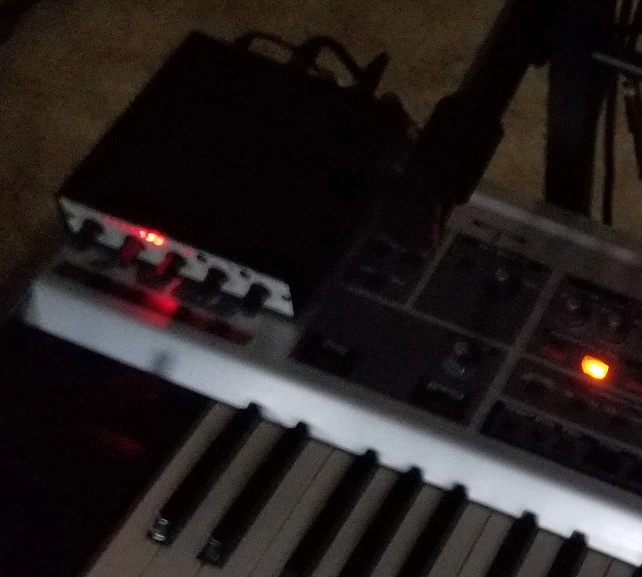

FMR RNC 1773 Attack is .2ms, but its a slower more musical type of the device. It colors the sound in a positive way. It would be perfect for duty on a Keyboard's outputs. Use it on vintage type waveforms. Roland MSV1 JV04 SRX07 or the like, and probably leave it there till you are sick of it. .2 Msec is just enough to get the transients to pop on MAX setting. Low ratios arent great for limiting duty. Hard to beat on vintage applications. ***Star*** this one and put it in yer favorites. Nice Job FMR! TRS insert, unbalanced. stereo. 25:1 max ratio.

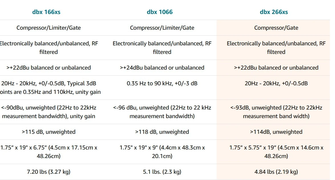

DBX 1066 , the 1066 is the best out of the 166-266-X66's. The DBX does not disappoint with specs or features. Great Attack .04 Msec. THATs what Im talkin about baby! Infinity. Expander gate. This is not the rich 160XT with a Jensen output transformer. This 1066 is a cheaper system and there is some loss through it. That kills it. Cause it has the numbers to be a champ. It doesnt sound like anything. The attack and release curves are not designed to add color. XLR TRS

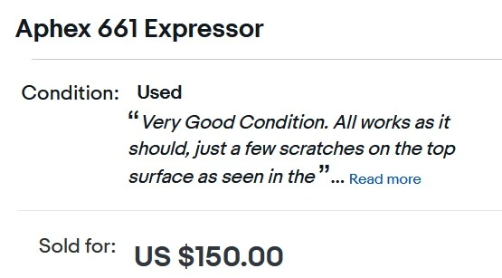

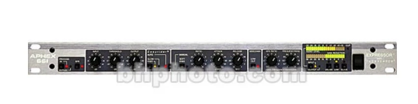

Aphex 661/651 .. Has the specs and numbers of a champion. Aphex kicks out a .05 msec Attack and a .04Sec release..Holy Shit thats fast hardware! TUBES! Transparent! This can do all the compressor tricks. It can redefine the sound with the HFX Aphex exciter circuit. Because after hard compression the first thing you want back are the highs . This EQs them, adding highs back in. Oh, on the inside. Each part has a jumper to defeat the parameter. So the tube, or HFX part is completely removable from the circuit. Has complete input gain and output gain knobs, for saturation tricks. XLR TRS TS link. Mono. 50:1 max ratio
The Aphex 661 or 651 are probably the best deals going. The FMR RNC is a runner up, but cannot do the tricks the 661 can. What can you add to this list?
