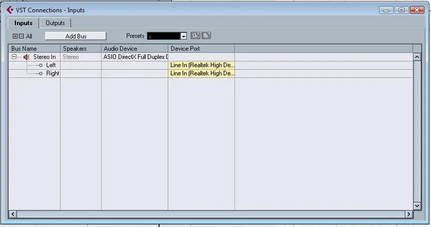

Hi everyone, thank you so much for the responses!!
I'm trying to figure out how to do this. Attached is a screenshot.
I tried to add a mono bus to it...but when I record with the mic, nothing comes out. What should I do?

Set up two mono busses. One needs to be the left input and the other is the right input.
then you have to go back to your mono track and select the input that your mic is connected to. (probably the left input)

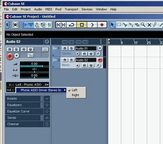

This is not the correct page to be looking at to set up a mono track in Cubase. I don't have cubase in front of me so no screenshots, but when you 'Add Track' you'll have the option there to select between Stereo and Mono. When you select Mono, you will then be able to select Right or LEft channel of your stereo interface, which I'm guessing is your Realtek soundcard. :eek: That's all there is to it.
He won't be able to select a right or left channel because it's set up for a stereo input buss. He needs to add two mono busses, one for each input. Both the mono and stereo busses can exist at the same time.
Ya made me go and find a screenshot... :mad: :D
When adding a new track, the input channel pulldown will have 'Stereo In' then, if it's Mono, it will also have a sub-pulldown for Left or Right channel.
This is an old pic of an old version, but it is the same in Cubase 5 which is what I have now.

Oops, I just realized that wasn't a screenshot for Add Track, but it still does the same thing. I'm traveling this week, so don't have access to Cubase for a better screenshot.
