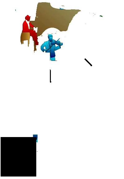

There's something I don't understand about your setup, 'cause I keep thinking like a piano trio, and I think maybe I'm wrong.
OK, take the attached images. Image A has the mics behind the pianist in ORTF (that crummy looking wide black "V" I drew). This is maybe not enough treble on the piano. Is that what you were doing?
Image B has the violin moved around the pianist, with the mics moved around to the treble side. This will give you a brighter tone on the piano.
Image C (pretend the cello is the vocalist) is worth a shot for the recordings with vocal without using the V67 as a spot mic. It will sound more natural, but the balance might not be right.

Krs and Mshilarious,
I've tried to move around the images Mshilarious attached so they look like what I had done in the recordings. Please ignore all the artifacts, I have no idea how to really use an image editing program. The big black square in the bottom is where the vocalist was with his 67G mic.

I panned each 603 about 30%right and the other 30% left and just a bit of the 67G center.
I missed that in the previous posting, Benjamin. If you're using the mic's as a spaced pair, or ORTF even, it tends to cause unpleasant phase problems if you mix them. Diminishes the stereo "soundstage" realism too. Good idea, as Mastac mentioned, to pan hard L and R.
OK now I understand. That explains it. The track is much hotter on the left channel because the violin is closer. The treble from the piano is suppressed because you're blocking it with your body. The right channel mic doesn't contribute all that much because it is farther. Notice when you play lower pitched passages the image moves right? Definitely, try diagram "b".
