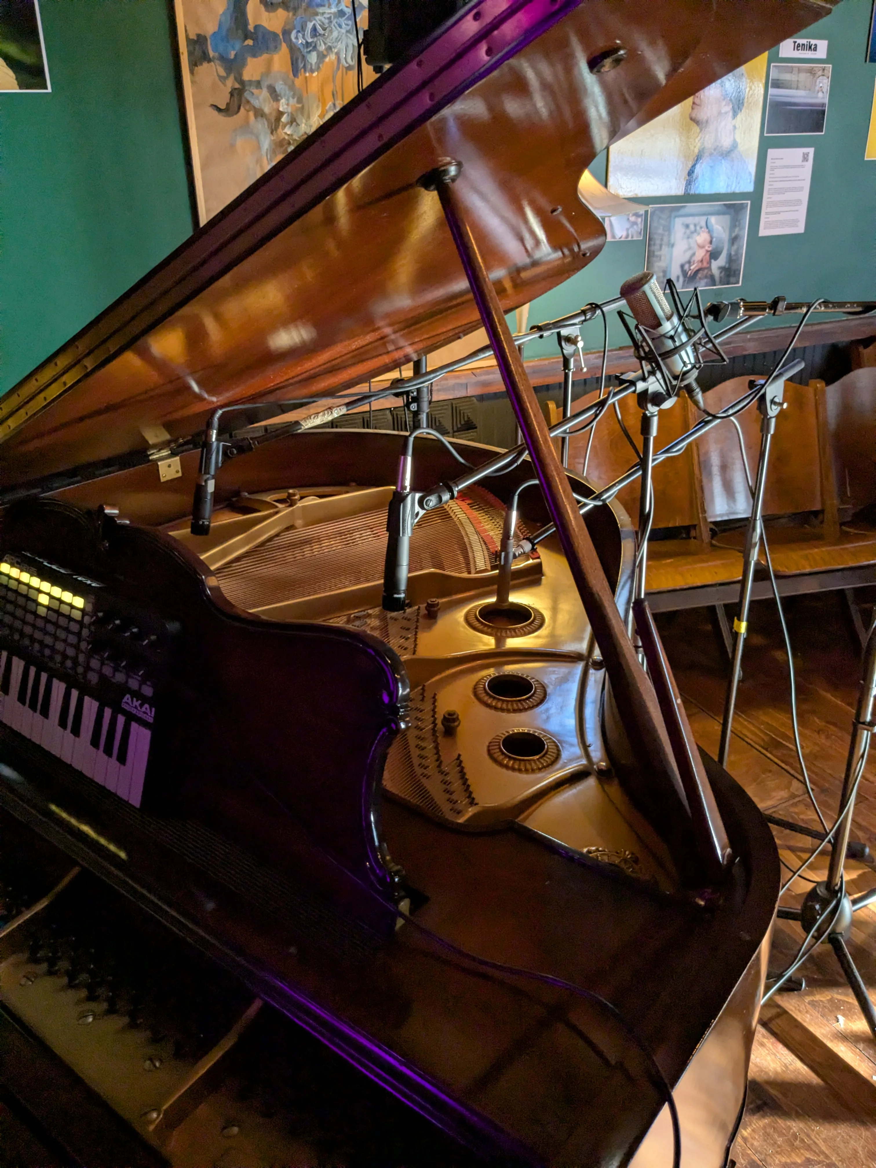

After spending some minutes with my head inside the piano, here was what I came up with for a mic arrangement.
Gonna mix it next week and see what came out!
That’s a lot of mics -

This was very helpful to consider as I was setting them up, thanks very much for the advice. I did initially hear some key clacking and rearranged to mitigate it.
Yeah I had no idea what any of them would sound like so I wanted to capture as much as I possibly could haha. I was kicking myself for not getting the matched pair of Oktava Mk 12s, if I had that I probably would have just gone with the two SDCs. I got that mic to record acoustic guitars and I really like it for that.
Anyway. Now I'm mixing it and I'm not too familiar with that either, so doing some experimentation with mic levels and how to EQ each mic.
It's not my song, otherwise I'd upload a snippet. I'll point to it once my friend publishes it though.

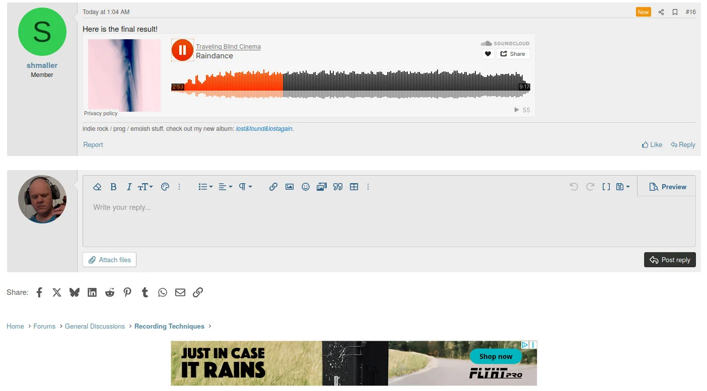

Here is the final result!
Dripping in the left ear was Ok. Sounded like distorted clicking in the right ear.
Like the sound of the old piano. No complaints about the micing.

the drips work, I guess, but the fake crackle was way too loud and as Raymond says, quite nasty in one ear. It's normal to start a piece with the effects but usually they would then tail off, leaving them there, but allowing the audio to shine - listen to blade runner vangelis tears in rain for a study in how to do it without getting in the way.
