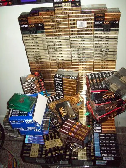

Here's an old pic of my stash that has grown 4 x's larger than this since I started gathering them. So yeah,..you can definitely still find them at a decent price...ya just gotta put a little work into searchin' for the right lot.

Nice collection!
Ha Ha! Thanks Dave! Yeah, it has grown since then!
My 688, 644, 488mkII, 464, 424mkII, 238S & PMD740 are hungry and have big appetites!:eek:
I keep feeding them,...but they seem to have a bottomless pit! :D:p;)
I wish I could put them on a type I diet!:facepalm::rolleyes:
