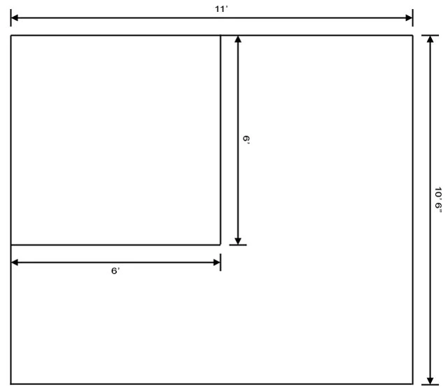

Rod and the others are giving good advice. I've included a quick drawing so you can visualize what you would be left with by building an iso booth. Even if you made it 3'x3' the resulting space would not be condusive to getting good mixes. Not only that, but when you consider the entry door into the room, the useable space will be made even tighter.
Treat the overall room, isolate your computer and record/mix in the same room. You're starting out with a small room. Don't minimize it any futher.
The money you save by not constructing the booth would be better utilized toward treatment.
Also, buying Rod's book, Home Recording Studio: Build It Like The Pros, will be the one of the best investments you'll make in getting it right.
