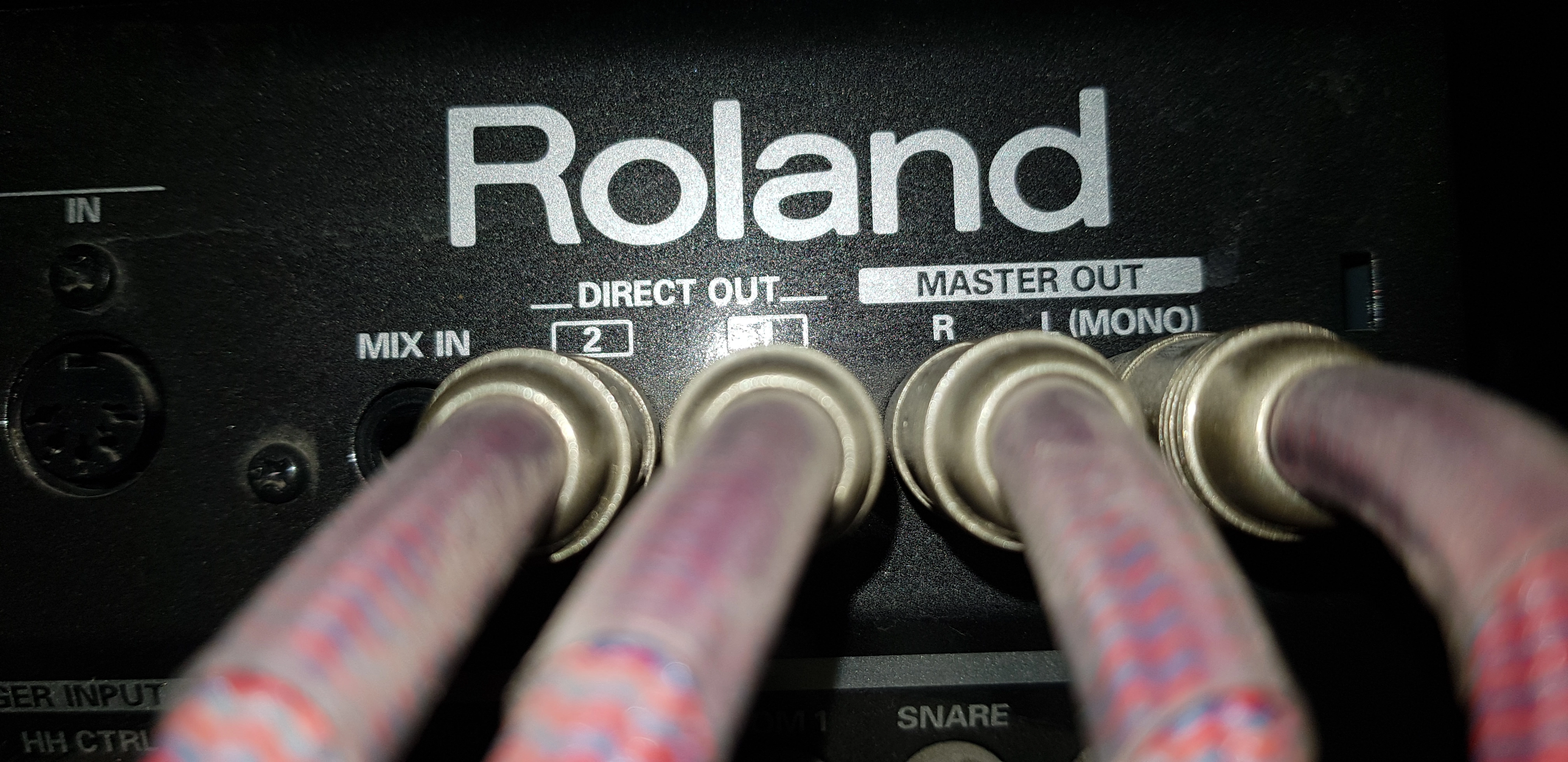

Do the levels show up on the Behringer display green lens. if they do, can you make the red peak light come on by turning up too much? If you can, then it's routing on the recorder. You mentioned you assigned the 4 tracks as OUTPUTS - do you have multiple outputs connected or just L+R? Did you set the routing for the channels as an input?
Does the system allow you to record OK using mics and guitars? If so - connect the drum module as if it is a guitar tom one channel and try that. If that works, then add the extra channels. In fact, if you can record guitar - then duplicate that to three more channels and check that each one can record to it's own track. then swap guitar for drum module.

the 4 outs of the module are assigned as Audio inputs in Logic. the levels show up fine in the sound card and I also get a "clip" light when i crank up the inputs volume to the top.
i attached a picture of the cables from the module to the sound card, each cable is a channel at logic.
I don't have a guitar at hand but what should be the definition of the channel? audio? instrument? midi? etc?
