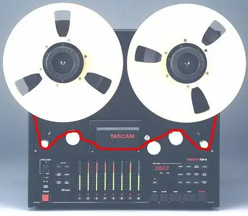

The first thing I would check is tape threading, as has already been mentioned. See the attached photo and excuse my sloppy drawing. First remove the two screws on the head cover and carefully lift it off so you have a clear view of the head assembly.
Next thread the tape and make sure the tape is making contact with the heads while in PLAY. Something to look out for is lifters that aren’t fully retracting. The lifters are the two shafts on either side of the erase head that lift the tape away from the heads during FAST-FORWARD and REWIND. Put the machine in FAST-FORWARD and check that they move outward against the tape. Now push PLAY and check that they fully retract so the tape is making contact with the heads.
