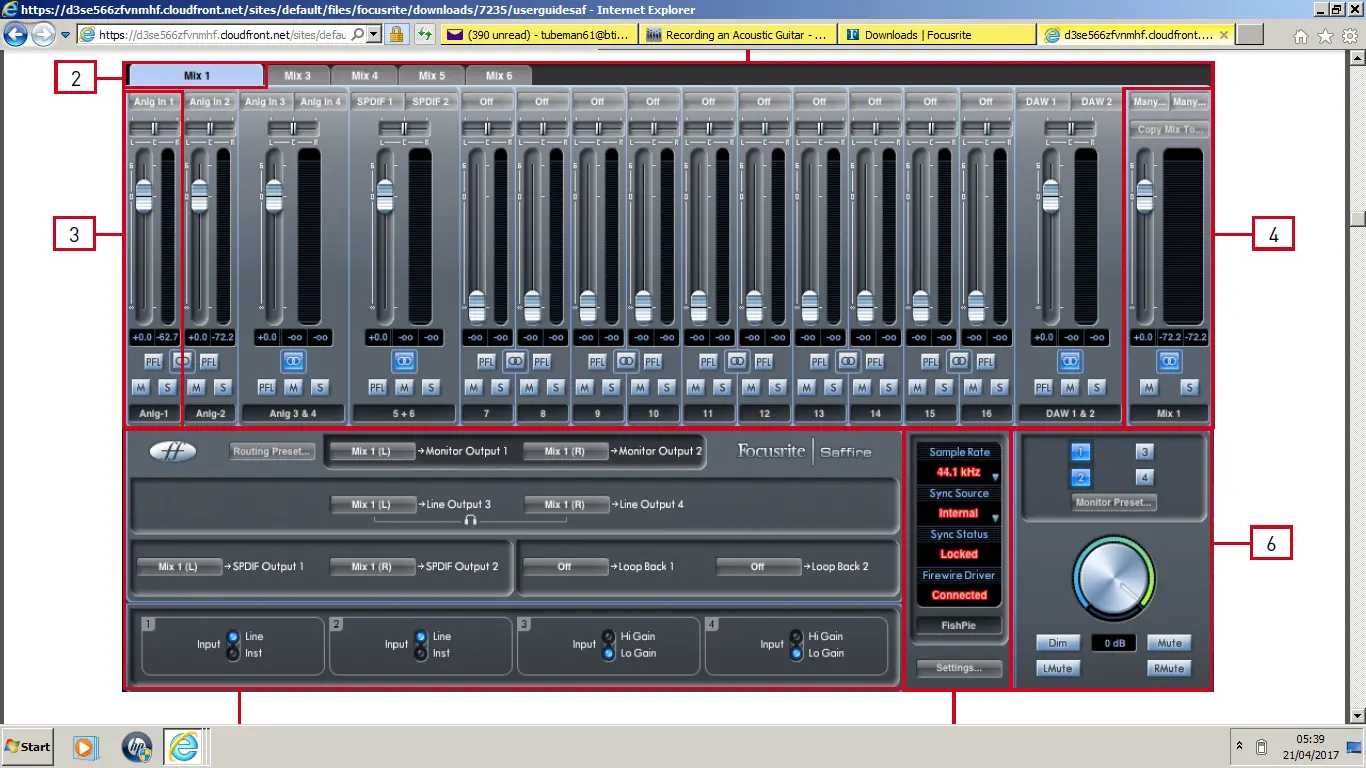

Are you sure you have not effe'd up something in the attached Mix Control diagram?
Yes, that mic is not the hottest LDC on the block but at -37dB (14mV) it is 2 dB hotter than my AKG P 150's (12mV) and son had no trouble with those into an NI KA6 which in fact has only 55dB of gain. Indeed, the 150s worked fine into a venerable M-A Fast track pro and that has VERY weedy pre amps!
In fact my son preferred the sound of a Shure SM57 for ac guitar and the KA6 needed to be on max for that with guitar about 1/2mtr away. IIRC (been a while) that gave us about -20dBFS but the KA6 was still easily quiet enough.
