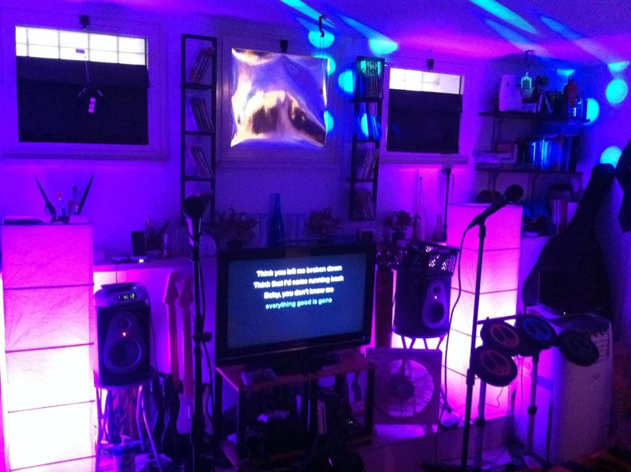

So I have a little set up in my home. My goal is to be able to use my computer to record a song using a karaoke track. I've been trying to find an answer all over and can't seem to find what I'm missing. (I'm pretty new with all of this)
To give you an idea of what I'm working with;
My "set - up"

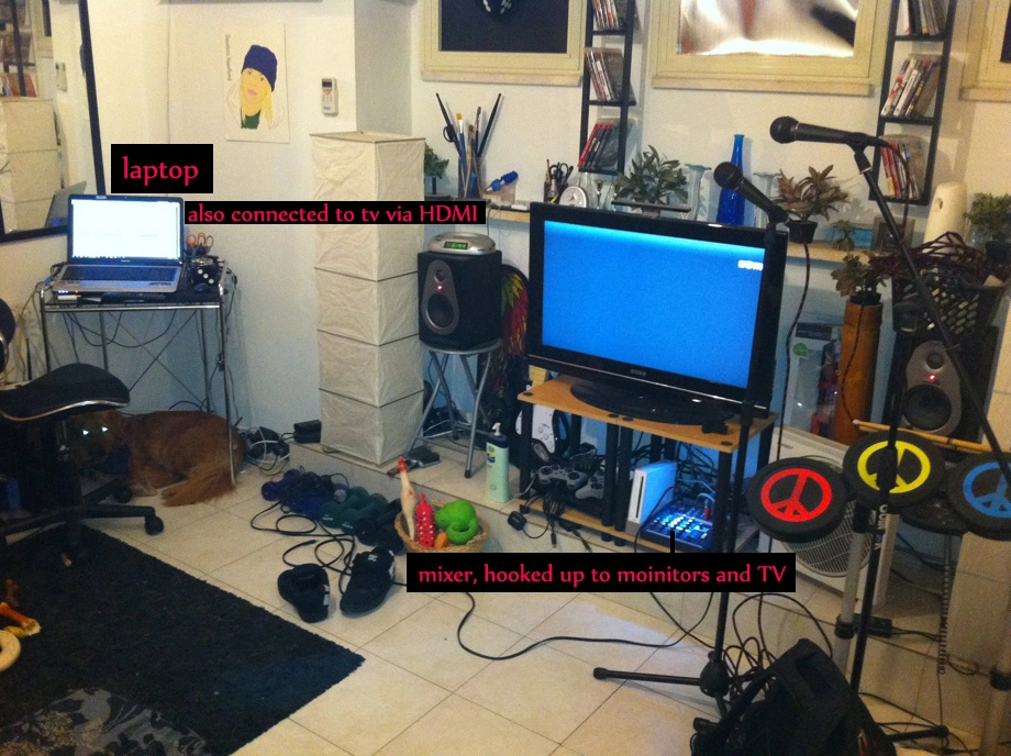

this is how I've been using it....

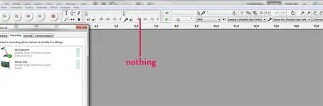

// I have connected the mic from to the mixer to the computer and seems to work in Audacity! :D
Sorry guys for all the annoying questions, but now I seem to be really stuck.

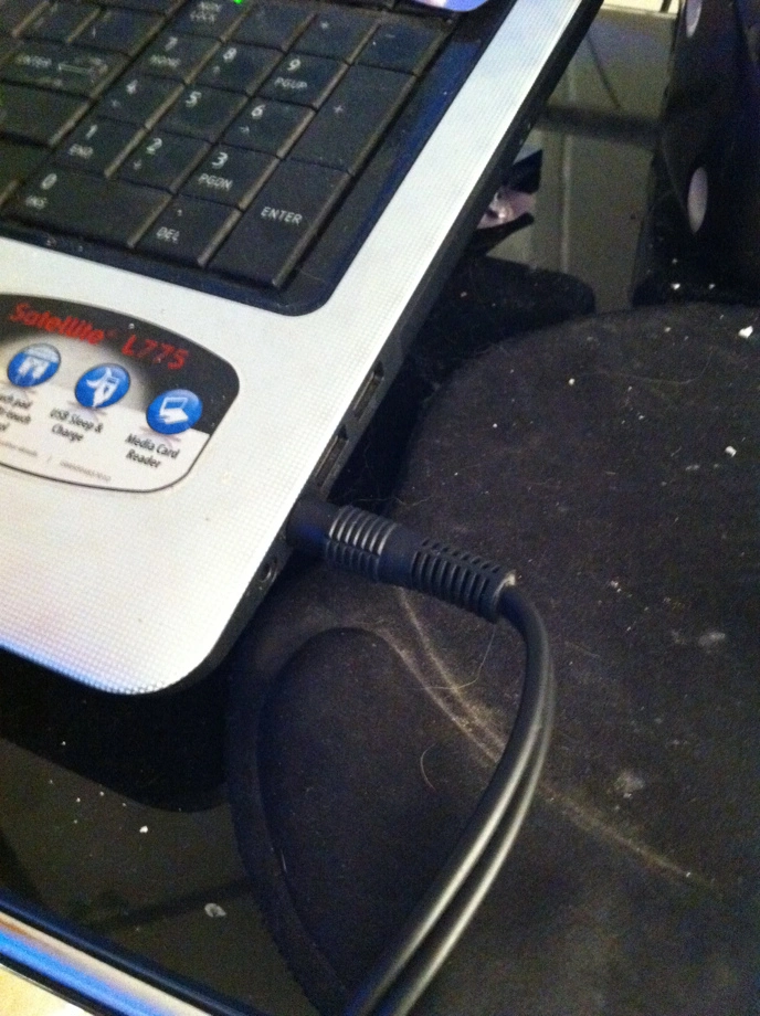

I've connected the mic to Rec Out on the mixer and connected it to the laptop, but doesn't seem to be picking it up on the laptop. - sound is coming out of the speakers-
Any ideas???

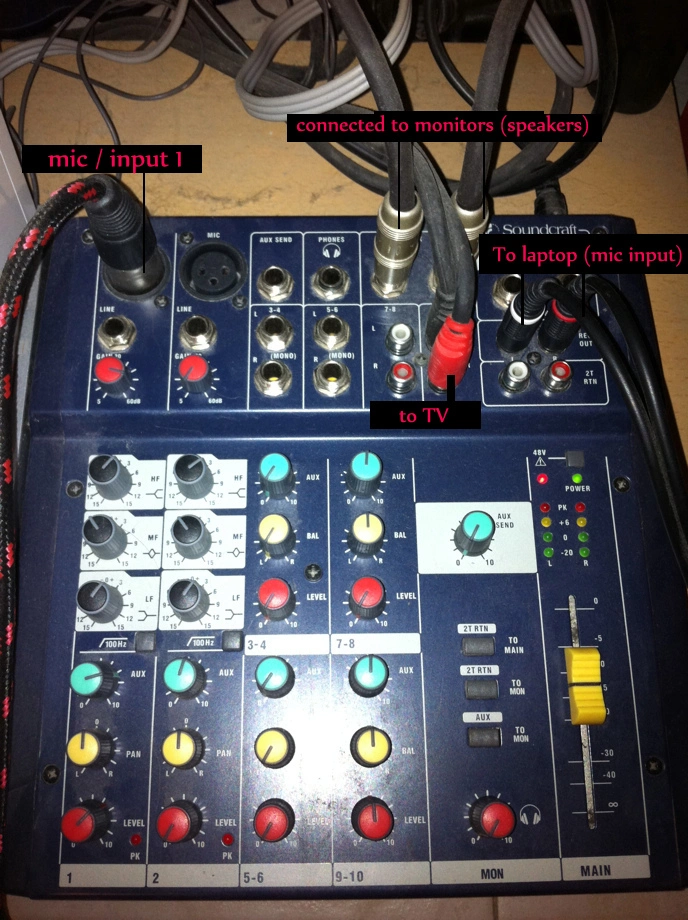

Your mic needs to be connected to one of the two mic inputs at the top left of the mixer. From the mixer REC OUT to the Line IN on your laptop (or MIC IN, if you don't have Line In), then in whatever recording software you are using, you will probably need to select the Line IN as the input device.
This is how it's all set up... I only hear it coming out of the speakers.
REC OUT:
Mic is plugged in, and on:
Connected to the computer:
Have any idea what the hell I'm doing wrong? Oh and I'm using Audacity to record.

I've tried all the options for the mic, and sound comes out of the speakers, but in Audacity, on the microphone (monitor) nothing seems to be picking up.

Just to clarify what you have setup.... you make reference to a laptop and a computer. Is the laptop separate from the computer? Is the laptop is playing the Karaoke and computer with Audacity is for recording?

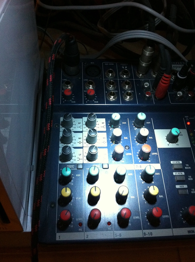

The mic is plugged into Input 1. You have other cords connected to inputs and outputs of the mixer. Can you identify where the other cords go?
Fill in the blanks....
Input 9-10 - _______
Rec Out L/R - ________
Mix Out L/R - _________
Just one laptop in this whole thing. (Win 7) --- And mic is not muted. checked the settings bunch of times.
inputs 9-10 are connected to the TV
the ones to far right is the cable im using to hook up the mic to the laptop.

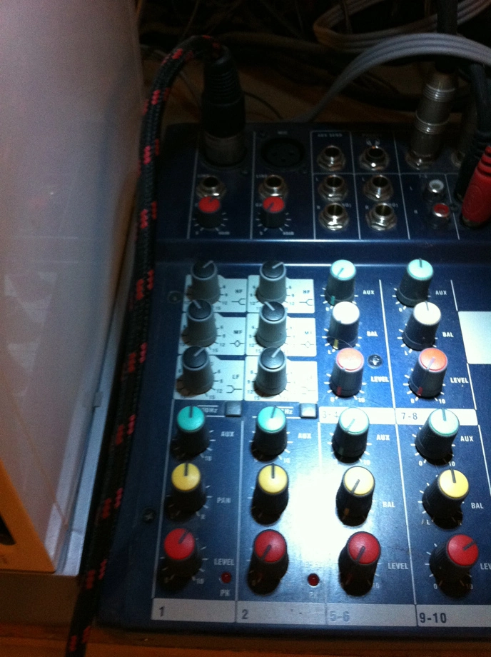

and the two in the back are connected to the moinitors.... here are 2 more pics, to get a better idea of whats going on.

When I tried recording in Audacity I turned off the HDMI and plugged in headphones. (I would try and plug headphones into the mixer, but of course I can't find the adapter piece.)
Also when recording, I just use an instrumental MP3 version of the song and have the lyrics in Word or something. I use the 2 mics and TV when I play around and sing karaoke with friends. - This is my first time ever recording myself not on a phone or something :P
Maybe if I try it again and turn off the monitors, it will be different... (going to try that now!)
And most of those buttons on the mixer.... no idea what they mean! I didn't know that was for phantom power... it's now off. I'm using a regular dynamic mic now and don't plan on getting a condenser mic anytime soon... (too much $)
Do you know what the little buttons on the right side do? the 2T RTN and AUX... I've tried getting some effects or something from the all the AUX buttons, but nothing changes, or that I can hear.
and again thank you!!!!!!!!!
YAY!!!!!!!!!!!!!!!!!!!!!!!!!!!!!
turned off the monitors... and it works!!!!!!!!!!!!!!!!!!!!!!!!!
