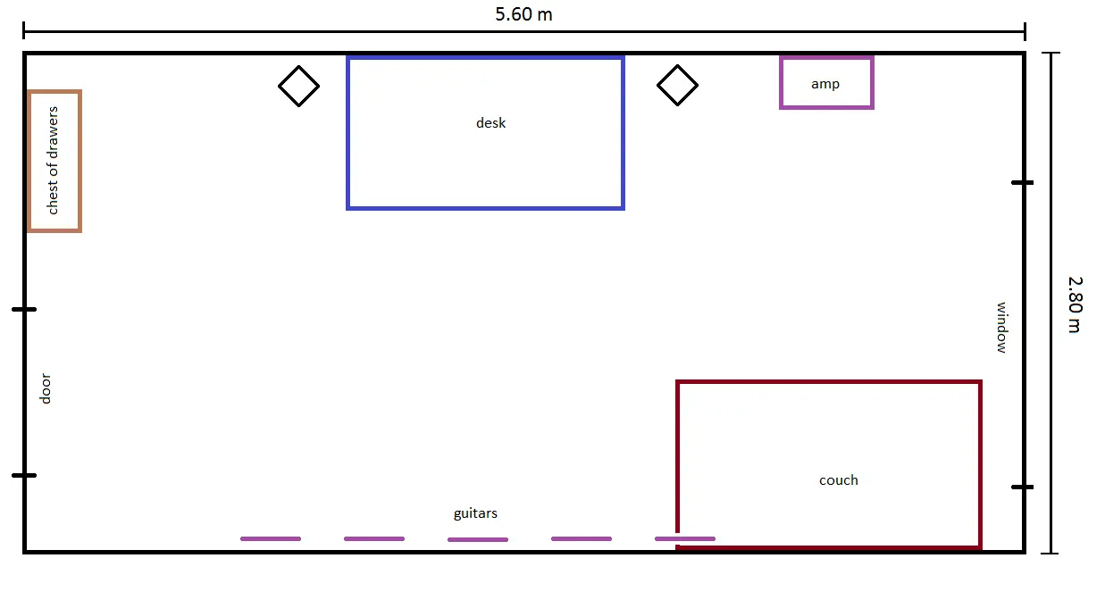

- one should avoid simple ratio between the different dimensions of the room; mine is 2.80 by 5.60 meters, so I guess a ratio of 1 to 2 is as bad as it goes (ceiling is 2.40 m, but that seem sufficiently independent of the other measures; oh, and walls are solid concrete, if it matters)
- the speakers should face the longer side of the wall, but in my case that would mean have the desk in front of the window and cutting out all of the light; so I have to have them face the shorter side of the wall
I made a little sketch to show how the room will be roughly organized. I should be able to put bass traps on each corner, but I am not sure if I can put panel in the back if hanging my guitars too (that's not been done yet, so I still can do that accordingly).
Every recommendation will help :) (well, almost - changing house again, for instance, is not really applicable :P )

You're right, the desk should be set up on the wall with the window - no way you can just cover that over?
Corner bass traps, and trapping on the walls are going to be needed for sure, if all the walls are concrete. Rockwool, not foam.
I would get a rack/floor stand for the guitars and plan to treat that wall, unless you can put the treatment behind the guitars. Center the desk, treat the initial reflection points and build some "clouds" while you're at it for over the desk at a minimum. What is the floor?
I'm not sure I'd give up on putting the desk on the short wall. Lots of people have to deal with windows. You can put an extra layer of plexiglas or similar in to keep out sound while still allowing light, or get heavy "blocking" drapes (what I did), giving up the light for recording/mixing at least, while still being able to open them if you want natural light in the room.
I recommend building panels yourself with (Roxul) Rockboard 60 (rigid mineral wool kind of product) as it's dense enough to be pretty useful without having to go to extreme thicknesses, if you can source it. Plus it's more rigid so a little less baling/chicken wire required to keep it neat over the years, especially if building clouds. I had to use Roxul's Safe'n'Sound, which is a dense batting 3.5" thick. Since you used metric, if you're in Canada you might find it, but elsewhere you'll have to look for equivalent material. Lots of instructions online but it depends on the material before you get before you start buying frame material.

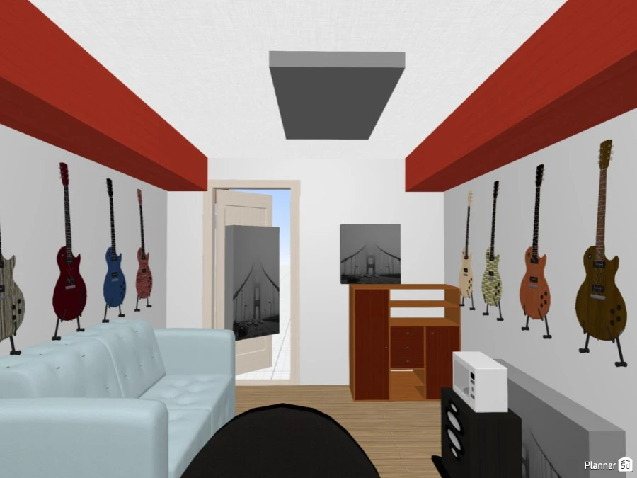

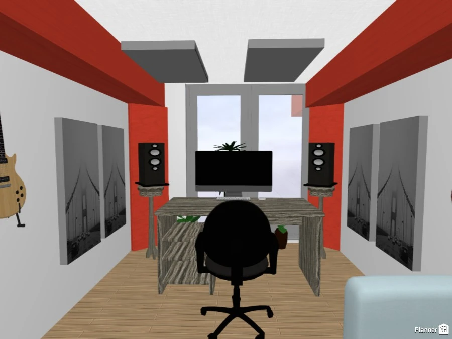

1) so I did give in and put the desk on the shorter wall of the room, i.e. against the window. The improvement is maybe not stellar, but it is there. In particular, I don't yet have my seat at the golden 38% of the room's length, but when I go back and forth I can definitely tell how that position works MUCH better (like, a lot of the bass buildup vanishes there - so relieving). So I will push the desk still a little further from the window.
2) I tried to measure my room, but failed completely so far. I got a Behringer measurement mic, but had to return it because I needed to do calibration and absolutely couldn't make REW work with my audio card's driver (it's an EMU 1616m). The calibration step is not necessary with USB measurement mics, so I'll look for one of those hoping I can go to the next steps
3) due to various size constraint I am afraid I'll have to renounce to the bass traps in the back, and do just with the one in the front and on the ceiling (I attach some renders, and you can also see the 3d model here: Floor plans and interior design - Planner 5D)
4) I got in contact with Gik Acoustics for some recommendations. As I am often quite busy with work, I am not too keen to go the DIY route, and I was checking out if I could make it with off-the-shelf components. I think I can use a few of their panels for first reflection points and backwall panels; on the other hand, I am not sure I can go with their traps as they're too large. Namely, the triptrap (41 cm large) would not fit in the corner on the right (where I have only 30 cm) and the soffit trap on the same side would block the door from opening. Can you guys recommend any smaller traps I could use instead?
Of course also any other feedback is appreciated!
