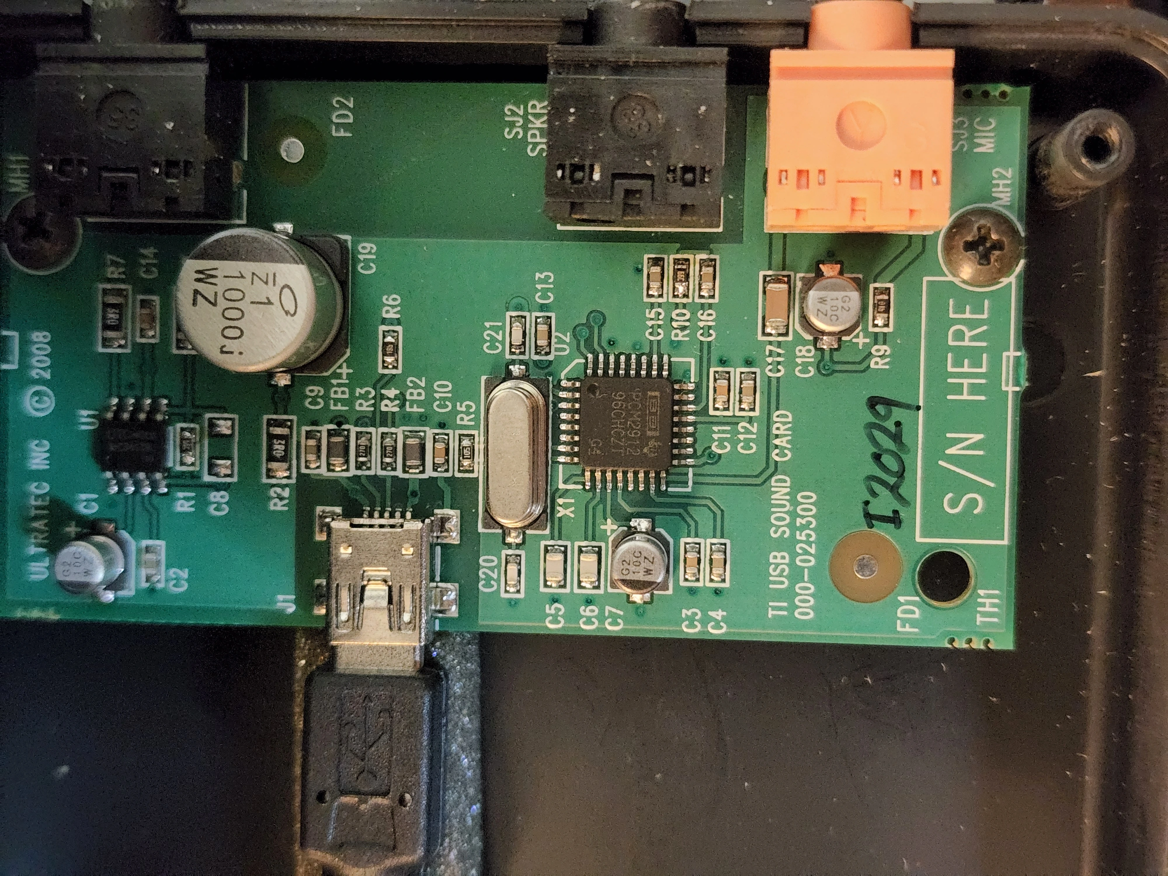

If I used an interface, I wouldn't be able to use it as an input or output because I don't have administrator privileges on the computer I use with the soundcard, with the computer being company property and all. I don't know what kind of soundcard it is. I can open it though and send you this pic.
I do have access to my own computer as well, though don't know if that would enable the interface to work with this soundcard on this other computer.
The board has a manufacturer date of 2008, and it appears a realtek chip. Realtek were not making very good chips at that time, they have improved a lot in the years since.
Anyway, any older usb sound device like that can't be very good. It's possible you could upgrade the usb sound to something more robust that has the monitoring features you want, then maybe route the input signal through some computer software for the gate (assuming the newer usb sound doesn't come with that effect/control).
I follow most of this, and think I understand the need for the gate, but it's also possible with a newer, shielded/grounded usb device the interference would vanish as it won't be as susceptible to the effects of the device causing the noise(?). Sometimes you just have to buy the right tool for the job, rather than learn black smithing to forge the tool.
