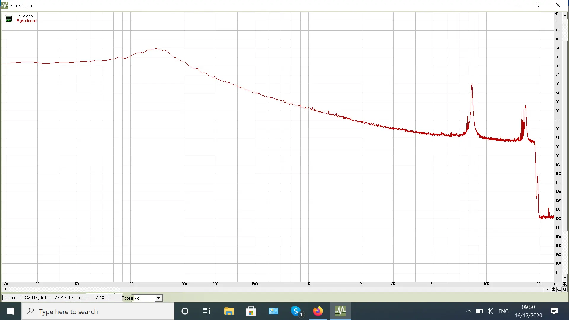

I looked at it - there IS a nasty spike at just over 8K and another at the first harmonic at 16K. Some people who can hear that 16K would find it very, very annoying. As to the cause - I suspect it could be the mic. Test by recording, and then unplug it but keep recording. If the tone vanishes when you unplug, it's the mic, if it carries on, it's your recording device input stage.

Attached is the normalized clip in Right Mak A. Yes, a plain 8kHz spike some 36dB above the noise floor
(the LF boost is either '1/f noise' or an artifact of RMA or a bit of both)
I would speculate that the mic has an internal oscillator to generate a polarizing voltage and some internal screening has come adrift?
