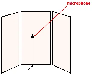

I will be placing them on guitar stands and using about 3 of them to help isolate the acoustic guitar from the rest of the room when recording. I attached a picture of what I'm talking about.
My question is, which guitar stand should I use? Would this one be good enough to support the weight? (I have no idea how much the average 2x4 trap weighs).

I just built bases for mine. Made a slot just wide enough in a 2 by 8 that my frame slides right in and stays there. Lay the 2 by 8 on the ground, and slide in a gobo. Works great.

Tragik - Thanks for the suggestion, I'll probably go with one of those. Looks like it will provide better support.
notbradsohner - I have absolutely no experience in building things so this is a first for me. I was thinking of building my own stand but I'm trying to keep this as simple/cheap as possible at first.

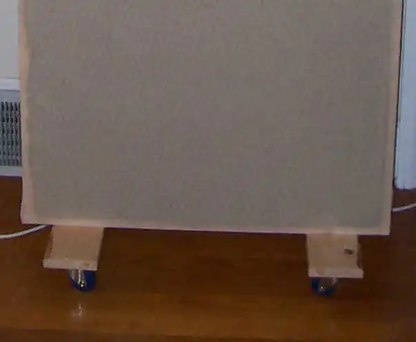

The A-frame stands should work for lighter panels, although, as suggested above, you could just attach extra pieces of wood to make "feet." I have some panels that I did that to, then put wheels/casters on the bottom so I could roll them around.
The weight of your panels will be related to the thickness & density of insulation you use. My 2'x4'x4" panels, made with 8pcf mineral wool, weigh about 22 lbs each.
Here's a pic of the casters on mine:
Yea, I guess I could just get a couple flat boards and attach them to the frame and use them as feet.

Thanks for the idea though scrubs, that's probably what I'll do. Cheaper than using mic/guitar stands.
One question about that: Is there a certain way to attach the frame to the feet? Do you think just using screws would allow the frame to tip back and forth? Should I use a combination of wood glue and screws?

I just used nails, but screws would be more secure. You could also get some little "L" shaped corner braces and screw those on. The main factor that will prevent tipping is the length of the feet.
