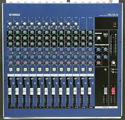

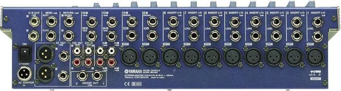

Anyways, here are some pictures of my mixer and what it has.
sorry, but their is just no way to "unmix"
it's like a board stretcher or a sky hook. it don't exist. :D
Alright. I was just wondering if it would be possible... :(
tju85 said:
I know what I should do, but I don't have $1k to do it. :rolleyes:
You dont need a thousand bucks to do what you want to do.
What you need is a sound card that has more than 2 inputs.
Then depending on how many inputs the card has, get that many number of TRS cables and insert each of them into the yamah's INSERT s on the back, but only HALF-WAY...first click.
Then do the same at the computers end, and there you go. Now you can record each "Microphone" seperatly.
TRS Cables- do they have 1/4 plugs on the end. Thats what my mixer has. (I have attached a previous post with the rear of my mixer)
Yes, you'll want 1/4" TRS cables.
What this does, inserting half way, is acutally use the TRS scheme that would send the signal (pre EQ usually, pre fader usually) out, then back into the signal change, (Insersts are used for effects and stuff) by inserting it half way, you are basically just using the "send" part of the cable and not have anything sent back into the signal, so it acts as just an output for that microphone.
